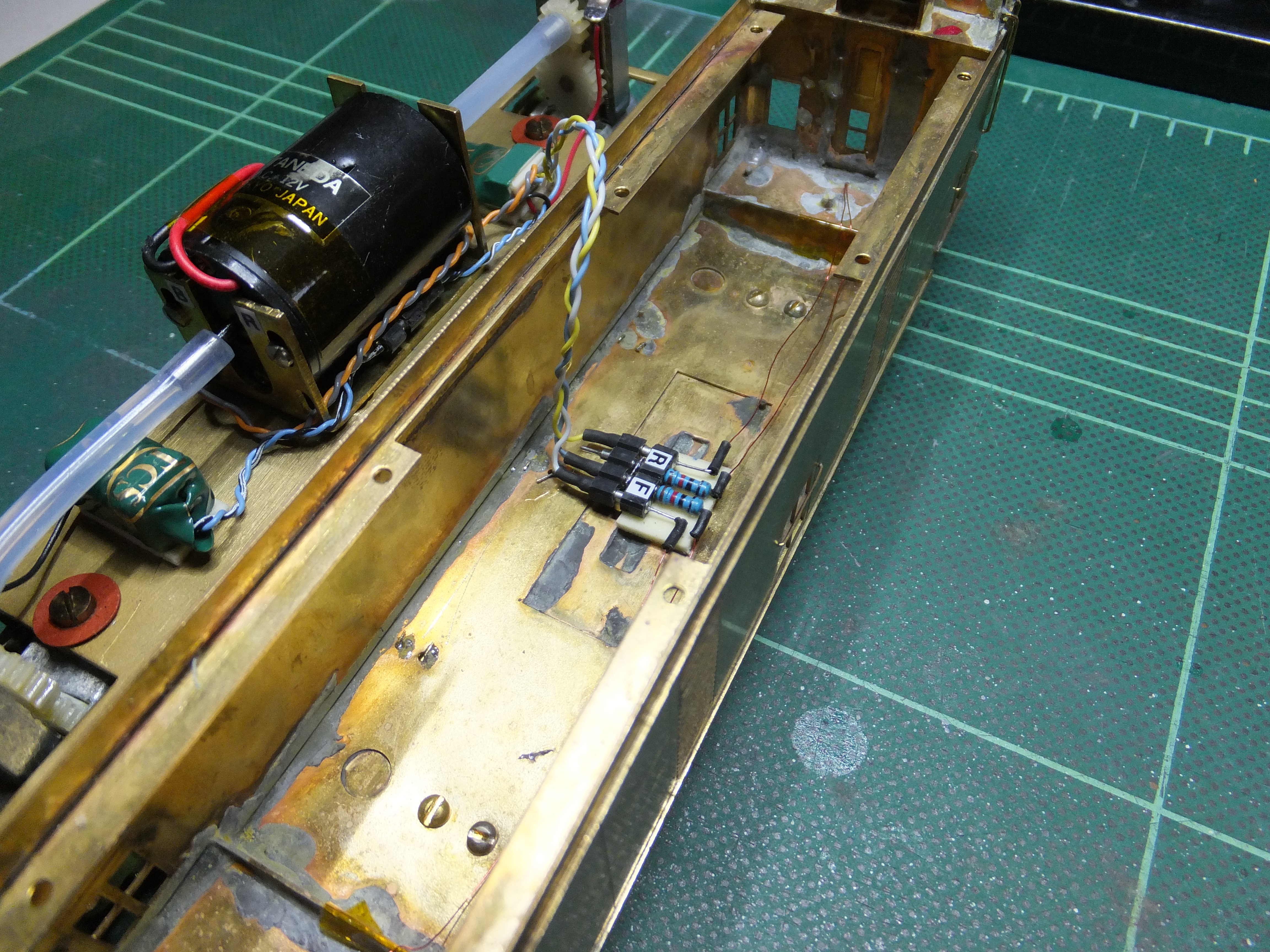

For long runs of wiring I like to twist or braid the wiring as I’m installing a decoder. For 2 wires I twist; for 3 or more wires I braid. This really helps tame the wiring and keep it confined and away from moving parts like drive shafts. It also makes it easier to tuck the wiring away or snake it through or around something:
