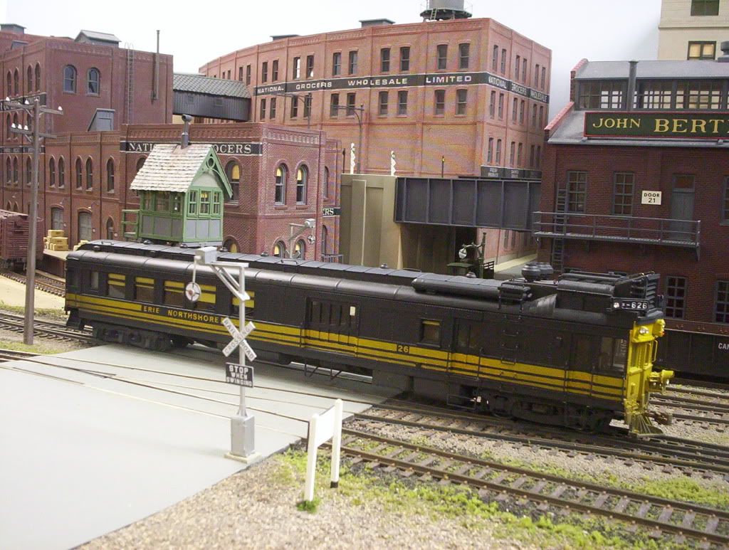

Then this kitbashed doodlebug (known locally as “The Bee”):

After some internal modifications to make them pull respectably, I acquired another two. Eventually, the diesels were sold off, with only the Mikes and the Bee still in service. Of course, in the road’s history, the Mikes came first, followed by the Bee, then the diesels. [swg] The paint scheme, if it isn’t already obvious, was inspired by the Nickel Plate, although it’s somewhat simplified.
