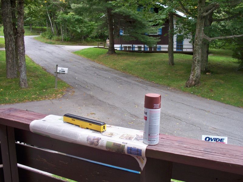

My Low cost spray booth. It isn’t all weather, but it does keep that paint smell out of the house.
You can make a “real” one very cheaply out of plywood, a bathroom vent fan that you get at any home improvement center, an air conditioning filter, and a length of dryer hose.
