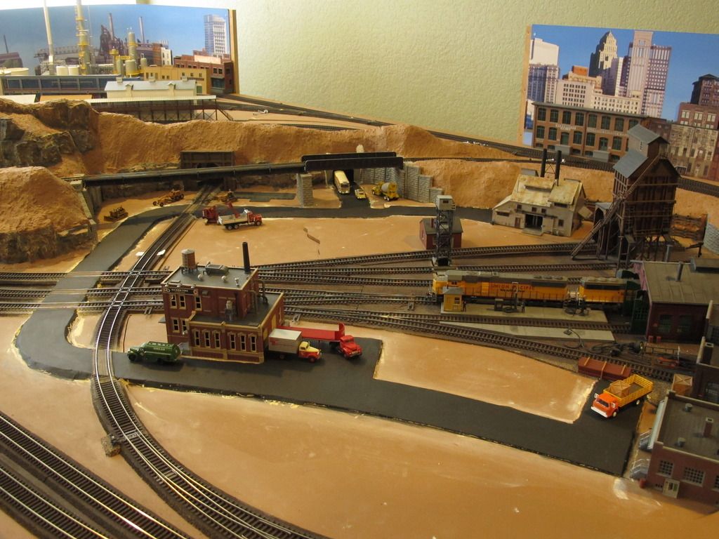

From suggestions in the Forum, I decided on Rustoleum #1918 “earth brown” spray cans and did the whole layout with it. I had not yet tried out my airbrush or might have another opinion. I was happy with the outcome, especially how the same color somewhat disguised the different brand track pieces, insulating rail joiners, etc. I like your idea of a different color for mainline versus sidings and yards. I plan to do some brush weathering before/after ballasting. I’ll have to read up on that.
That track looks really nice. Now wait untill you get it ballasted, will really look great. Looks like you made the right choice. Ken
