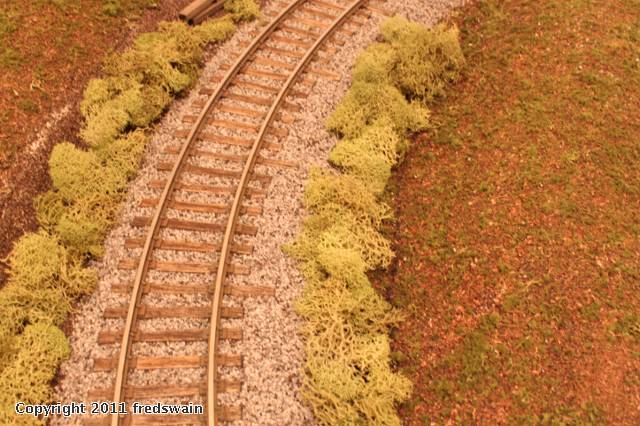

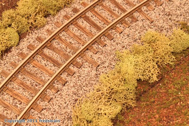

My club used to stain wood ties for years using Old English furiture polish. The short time effects looked good but alway faded out to requiring additional coats. This was fine for ties that were to be old weathered ties as washes or dry brushing to a more silvered aged look worked. If you want that newer creosote look, then stains such as Minwax, Am. walnut, Jacobean or any other stains representing that dark brown can be used. Zar teak natural and walnut is a great choice, but not always found. The Zar stains are a very heavily bodied oil stain and can/ should be thinned for use. Minwax has been getting quite thin w/ a serious amout of vehicle that can also fade and bleach out once dry.
Dear Fred,
That is really lovely work there… well done!
