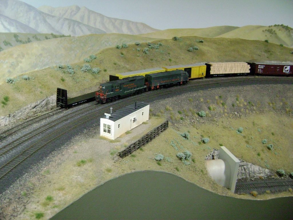

There are different preferences you’ll encounter, but I consider fascia to be entirely integral with the scenery, so I install it first to allow scenery to be attached to it and overlap it.
Here’s a typical location on my layout, showing scenery built around the fascia and a fully overlapping edge where the top of the fascia is covered with scenery material. If you wait to fit fascia until after scenery is complete, getting the contours to match will be far more difficult, and achieving a high degree of fit and finish will likewise be tougher. Install fascia first and the transition can be seamless.
Since track usually needs to be painted and weathered to look its best when ballasted, and scenery work tends to create a mess that gets where you don’t want it from time to time (regarless of how well you protect the track), I strongly prefer holding off on ballasting until last. This also allows an easy transition from ballast and other right of way detail into the surrounding scene.

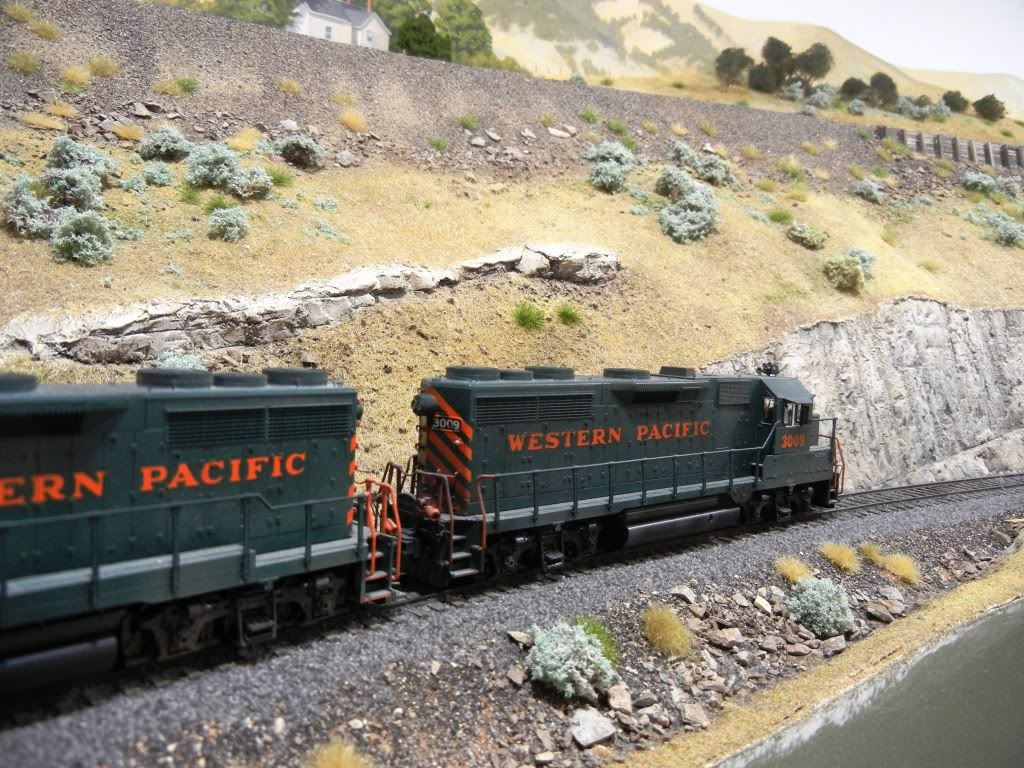

Note here how the fill was built up from dirt and rocks on top of the scenery base, and the ballast added on top of that. I couldn’t have ballasted first, as the fill that is supposed to be “holding up” the track couldn’t be built until there was a scenery ba
