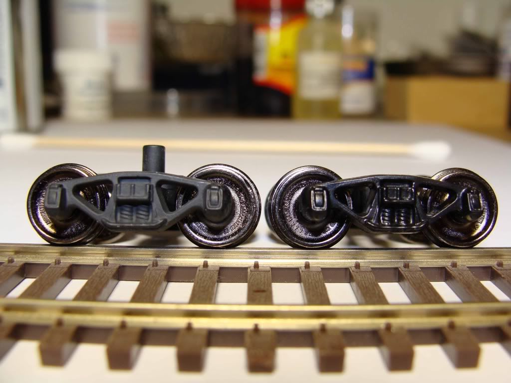

Everything seems to work great. Just now did one side frame as a test. I just held the thing in my hand and blasted it toward a cardboard box outside on the deck. I just wore a plastic painting glove to hold and rotate the sideframe in my fingers to get an even effect. That seemed even easier than moving the airbrush/sandblaster around it.

The result of my first effort on a basic sideframe can be seen below on the left.
Well I must say you have great results. Will the truck now fizz in vinager?
looks like you knocked the shine off of it and gave it some “tooth” so paint will stick better. let us know how the paint job turns out with some photos if you can.
