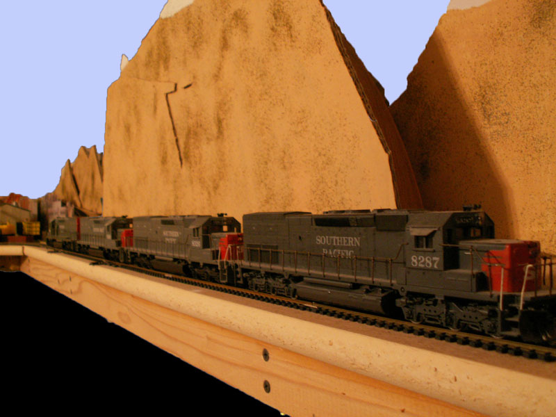

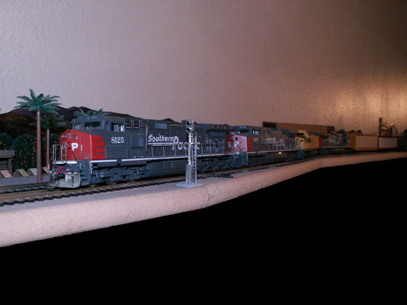

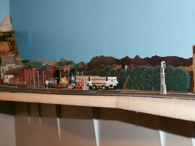

I have one in my bedroom which the width varies according to the furniture which is under it. It is widest over the chest of drawers and narrowest over the bed so I don’t feel claustrophobic. The width varies from 6 inches to 16 inches and is made to angle between those widths. The height is about chin height so it is a few inches higher than the chest of drawers. I think the closer to eye level the better for viewing and it makes the layout seem larger and distances between areas longer. Here are a couple of different sides which are the narrowest.
A quartet of Southern Pacific tunnel motors waits under the arrowhead.
Southern Pacific freight train with lumber passes through Redlands
The Sunkist packing house is located in the orange groves of Highland
