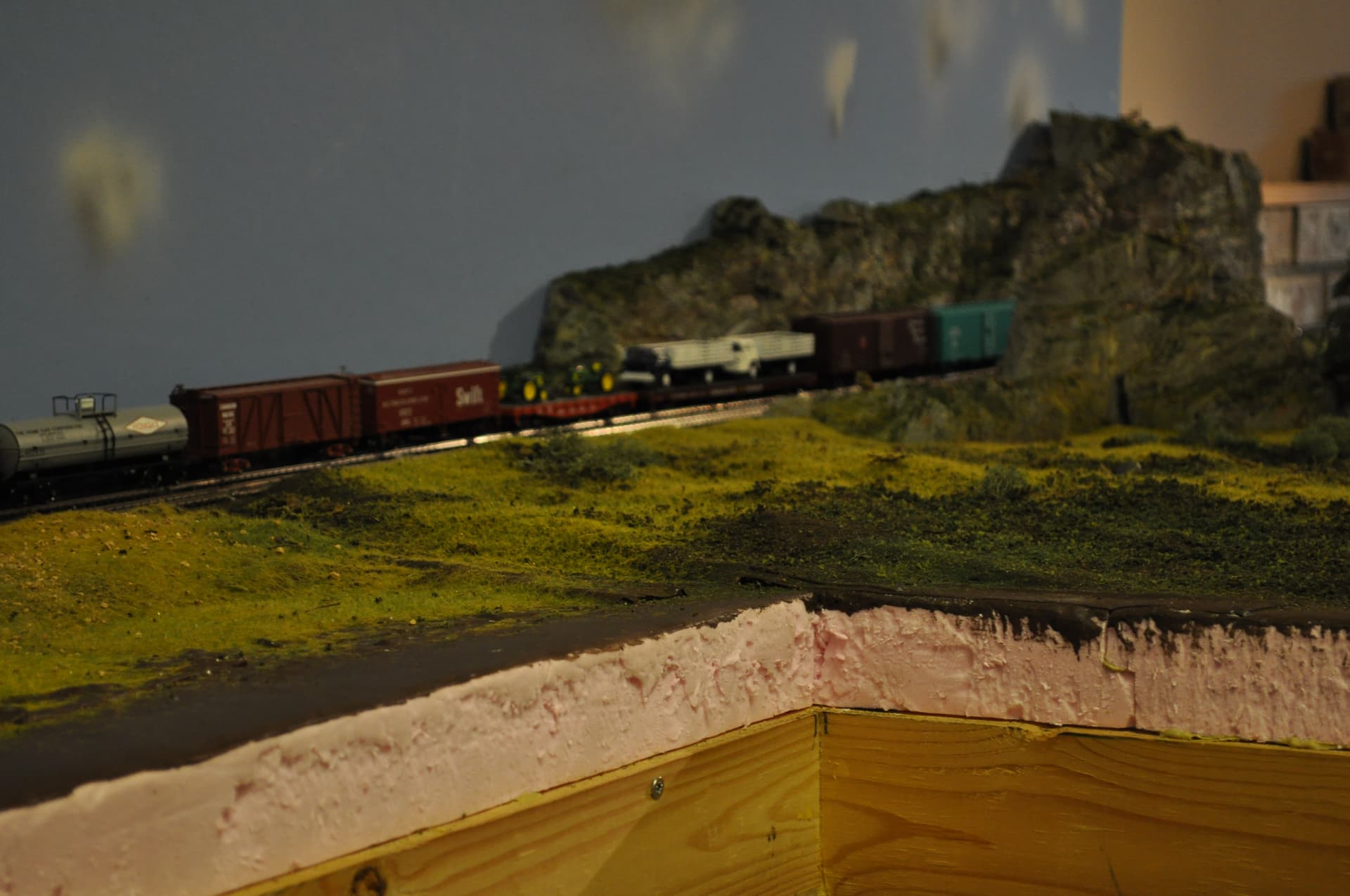

Here I have cardboard strips that I covered with Plaster-of-Paris dipped tea towels. Just one little spot, but the perfect way to get the look I wanted in that spot.

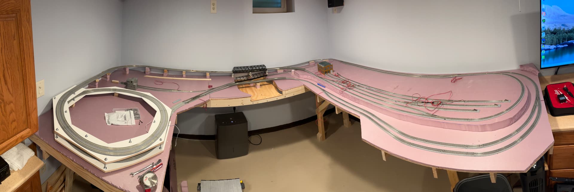

1/2” foam over 1/2” CDX plywood on a L-girder frame. You can build down or up as needed. A 12” long drill bit is all that’s needed to make holes for wiring.

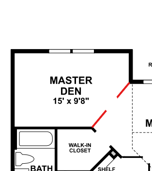

I’m working with this space in a den attached to my main bedroom but I just realized my image size isn’t correct, the room is actually 4’ deeper so roughly 15’x13’8" and my wife requires the new red divider since it is a part of the bedroom. I probably won’t do the new wall until it’s a bit cooler as I’ll need to be in and out of my attic space. I currently have a 4x8 almost fitting on the top right corner wall right now. The corner of that benchwork will just become angled and since it’s a 180 degree turn I won’t miss that surface. I’m planning to go double mainline and one of them will not go below a min 24" radius. As I lay out the benchwork I may shoot for 26" but I want the room to be comfortable to walk in. I’ve been using anyrail to help, but it’s one of those things I may change up as I go. I could easily do a double decker, but I need to be reasonable with what I think I can accomplish. I may utilize the space below the main level for staging though and I plan to keep my benchwork legs back from the edge so I can do some scenic work there as well. As I’m typing this I realized, I may go with a higher base level so that lower level isn’t so low.

I would suggest plywood with 2" foam on top. The foam, while expensive, is very forgiving offers a lot of variety for elevation. Regardless of how you carve into the foam, ensure you keep a vacuum nearby to get all the foam pieces. They will go everywhere!
