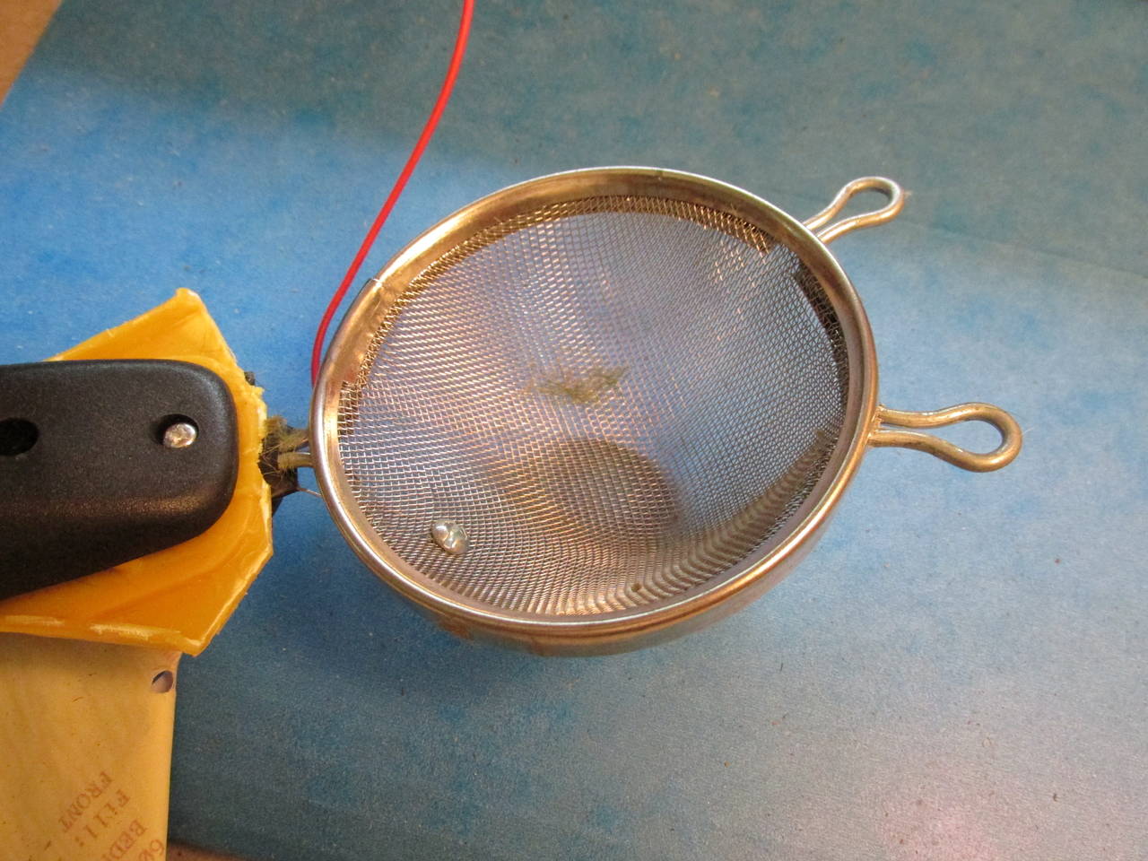

This is my Grass Tech applicator.
It’s a small kitchen strainer, really, about 3 inches across. I find this works very well for 2, 4 and 6 mm grass, the only ones I’ve tried. I like the 4 mm stuff best.
