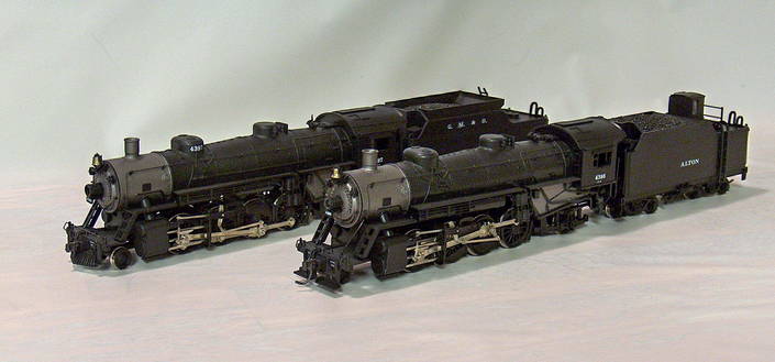

I think that I’m a bit of a rarity: I’m under 50 and not only do I “fix” my own steam, but I don’t hesitate to strip them down to component parts, remove ALL of the detailing, and start over to create prototype-specific engines.
My dad tought me to work on steam when I was a kid (early 1980s) by handing me some of his old (1960s era) Mantua and Varney steam. I’d run the engines until they stopped, wander them over to dad and say. “It’s dead”, whereupon he’d show me how to disassemble, clean, fix and reassemble the engines. Eventually I didn’t need to ask dad any more, unless I ran across something really strange.
Nowadays, he’ll come over to my house, hand me a box full of an engine and parts (he’s now in N scale) and say, “I want this (pick a prototype) for Christmas.” Not hard to understand when I’m cranking out engines like this:
In fact, just this morning I dragged out three steamers, two brass and one Spectrum 2-8-0, which need to be worked on. They all need to be stripped and redetailed into specific engines.
