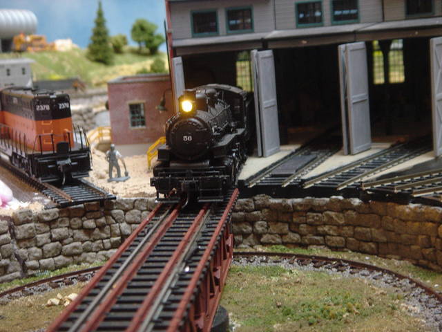

The extreme case is this casting for my turntable pit, using the “weathered wall” mold:
That one fits inside a 10-inch diameter circle. The final product came out like this:
This is a different mold. It’s called “cut stone wall.” The picture isn’t as obvious, but it curves away in the lower right corner. I put several sections together for this scene, where the stone wall provides a retaining wall on either side of the ramp going down into the subway tunnel.
For the curved sections, I first made up a matching template out of scrap foam. Then I tacked a piece of cardboard over the foam curve, holding it with bent paper clips. (Since the mold is 3 inches across, and the foam is only 2 inches thick, the cardboard is there to make it wider so the edges of the mold don’t droop.) I mixed up the Hydrocal and poured it into the mold, and then waited about 10-12 minutes, until the Hydrocal sets up but isn’t hard yet. At that point I placed the mold on the cardboard/template. After the Hydrocal sets, you’ll have a curved wall section that matches the curvature of the template.
For your situation, make the template concave, because you’ll want the surface to come out convex. If you were making an interior curve, like the turntable, then the template should be convex so the face of the mold w

Here is a pic of a retaining wall along Brandywine Creek in Coatesville on my layout. The wall is made of H&R embossed shingle material.
Dave H.

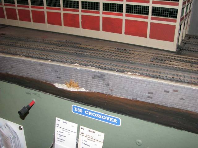

This is made with balsa wood strips. I used a Dremel to notch the stock at 8 scale foot intervals (about 7/8 inch in HO) and then stained it with India Ink.
I your case, you could use the retaining wall to build out the upper part of the bank, and then just scenic the lower part with turf. You wouldn’t have to do the entire embankment - just the parts near the corners of the buildings where you want a bit more space.
