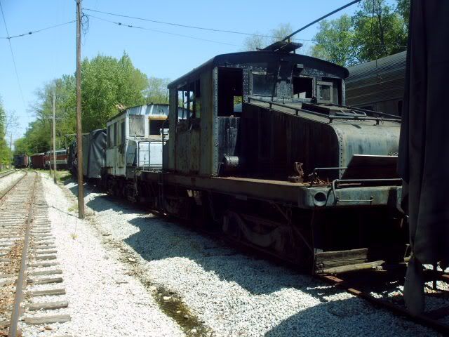

Some yards are basically flat (see below), and sheet cork would model that well.
Other yards have a bit more drainage to them (see below), so the rails are set a bit higher then the ground, like the N scale cork would do.
(Admittedly this is a storage yard now, but it was used in regular service at one time.)
