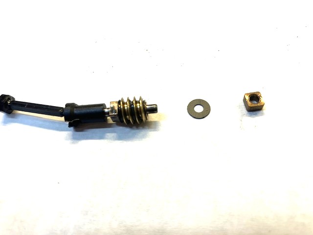

Only doing it in one direction makes me suspect worm gear lash is too loose. You adjust this by removing the worm gear from the top of the gearbox, and inserting shim washers in one end so that the worm gear doesn’t move back-and-forth in line with the driveshaft. Put in just enough washers that there is no slop.
I will give it a try. Thanks
To try to determine if it’s the drive train (e.g. excessive gear lash on worm) try pushing the loco along while it’s running and making the noise. Give it just enough force to unload the drivetrain. If the sound disappears, you can really concentrate on the drive train and not something hitting the motor and drive shafts. Also, check the axle gears for any damage.
