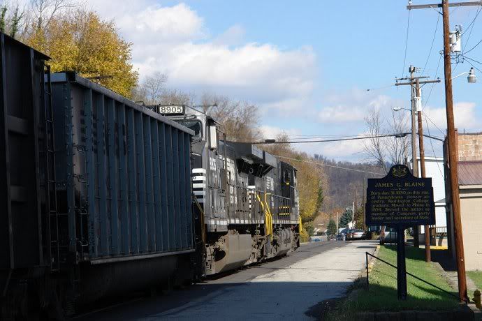

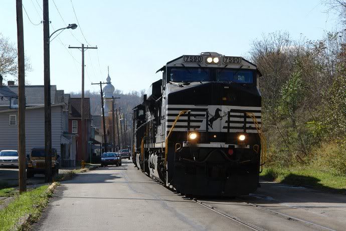

I have always wanted to do some street running on my layout. Heres a few shots of real life street running, if it helps with ideas.
I suggest looking at street signs too. Including signs marking Weight Limits next to a BIG honkin engine.
