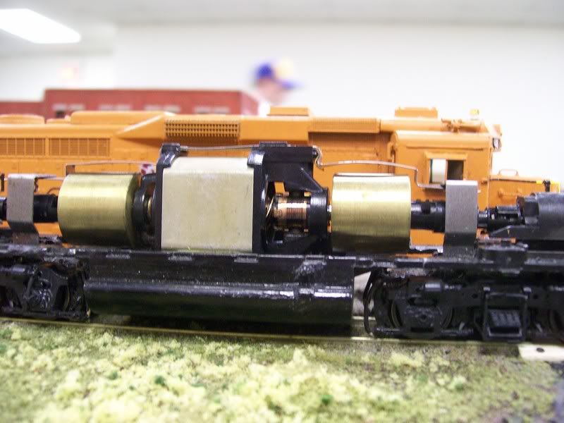

The A-line-Lionel-Bachman shells are not nearly as nice as the P2K shell. The original Spectrum drives left much to be desired. I repowered mine with Athearn BB GP35 frames. Here is a shot of Spectrum and P2K back to back.
I highly doubt that the P2K drive will fit without cutting a good deal of the weights.
The orange loco to the left in the picture have Alco trucks, right? It’s the trucks on the loco to the right I want for D&RGW?
That is correct. ALCo trucks (as shown on the orange one) were used on Soo, MILW, GM&O GP30s, maybe others. The rest (black one) got EMD Blomberg trucks. The P2K ALCo trucks have the proper 9’-4" wheelbase. EMD trucks are 9’ even. Sideframes will not interchange. Are factory painted DRGW GP30s unavailable, or would you rather roll your own?
