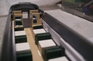

One additional step I take upon reinstalling the interior is adding window shades with long strips of styrene on each wall. After lining up the styrene strips, I make pencil marks on the spots where they will be visible from the outside then trim off between 1/8" to 1/4" to simulate the shades in different postions as in the photos below:
