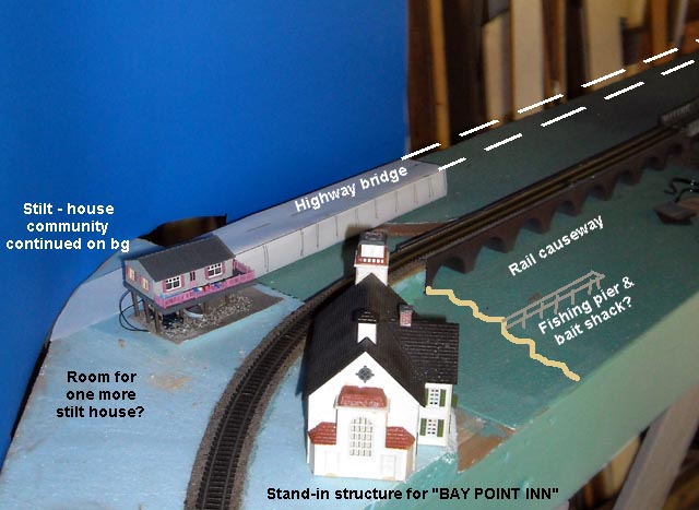

I am not sure sure about joining masonite and styrene. I am using thin styrene for all my backdrops. I bought 4 x 8 sheets, I think 1/16" thickness, sliced them in thirds to make 8 foot lengths 18 inches high.
Three corners of the train room are situated so that I cannot “round” them. Two have windows “dead” against the corner which must be at least minimally openable. I put rejmovable sections in front of them and make square corners I wish I didn’t have to. Have to disguise as best I can. The ship to the right is on a removable piece of BG 3 feet wide.
But I have one (count them , one!) semi-rounded corner at the mainland end of my “two mile causeway.” Here is a mockup I did at an early stage, using a 39 cent sheet of posterboard to stand in fron the background painted on styene.
And here is the mockup from the back. I used thin lath strips to fasten the curving background to the section back. (Most of the layout is against the wall, with wall-mounted BG.) I used tape and clothespins and clamps for the mockup. The actual background used the same lath strips but they are contact glued to the styrene and screwede to the back of the layout sections. Not only on the curved corner but all the way.
