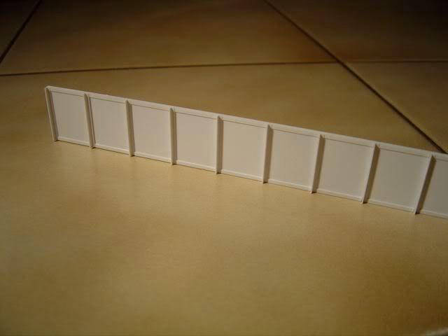

I just started to build my hanging bridge with styrene. And I love it! I can’t imagine using anything else now or in the future. Styrene rules! [swg]
Looks super so far, Electro. Is this a kit, or are your scratch building this one?
I’m scratchbuilding it from Evergreen sheets, strips, angles and thing like that. Everything is cut to size with NWSL Chopper II. That tool is really good. I’m gluing it with Ethyl Acetate and a little brush (000). I got 1 litre from my local drugstore for around 14 USD. I have glue for a lifetime…

From my experience with the material years ago, it does not seem like it would be as effective a solvent for styrene as commercial adhesives. Does smell nicer than most commercial solvents, though it still should be used with caution.
You might check the strength of the bond to be sure it meets your need. If not enough of the styrene on both sides of the joint has “melted”, it may be just the dried ester that is holding the parts together. That may not hold up over time.
