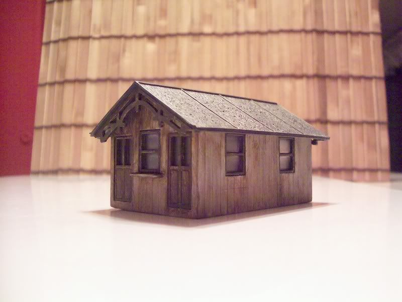

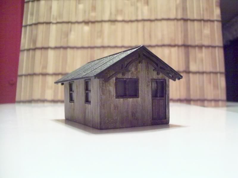

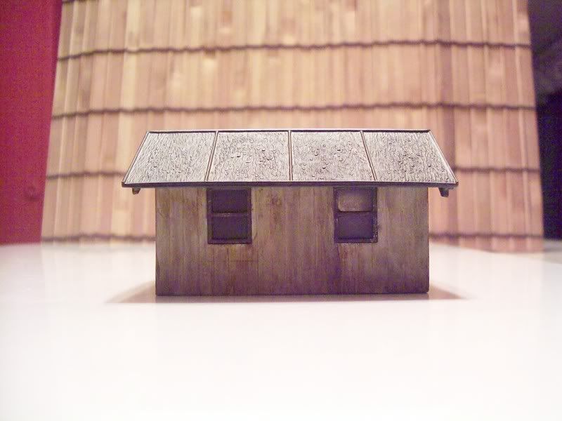

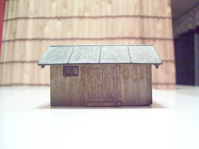

I was trying the method described on the Pacific Coast Liner site to get a realistic looking wood effect. I didn’t have the exact materials they recommended but I don’t think the look turned out too bad. What do you think? The dull coat reacted with the alcohol wash in a less than desirable way, but I finished it anyhow.
I think it looks great !

I wouldn’t be able to tell it was plastic unless i smelled it

Thanks all! They recommend using Rit fabric dye which is water based. I didn’t have any so I tried India ink/alcohol. Not a good idea is your going to dull coat. The dull coat reacted with alcohol and crazed the finish and turned it a little white. It looked a lot better before the dull coat. (live and learn).
When they say rough up the plastic, REALLY rough it up!
That’s just an old Plasticville depot building. I think I’m going to use it as a gate house for my lumber yard.(or office)

FoulRift-Thanks for that tip. Maybe that was the problem. I know many folks use alcohol washes to weather, but i just can’t seem to get the hang of it. Most of that building was done with artist acrylic washes over the ink/alcohol base. (raw umber/raw sienna)
I have been using the Dull Cote/ alcohol weathering technique for some time now and I like it. The only problem is that you do not have complete control over the results. (Similar to real weathering) However, you can erase most mistakes by re-spraying with Dull Cote. I first learned of this technique from an article by George Sellios.

If I could fly an idea past your front…the window sills would, over the time that the structure had ostensibly aged to its present condition, have imparted some detritus (dust, pollen, dead bug carcasses, etc, organic material) and washings of their own down the first scale foot or so below them, and I would guess that there would be a resultant stain just below those sills…would you agree?
Just a thought to put one of the possible stunner details on this model.

Thanks! That’s a great idea and still do-able.[tup] This was kind of a test building to try out the technique. I recently got some cheaper kits that are (plastic) wooden structures. I wanted to get a handle on things so I didn’t ruin a larger building. You never stop learning in this hobby.[:)]
