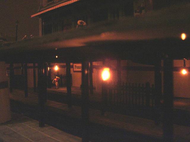

Just one of those weekends for me. I knew I wouldn’t do much layout work Sunday, because I was off to an open house at the South Shore Model RR Club, a good hour away. Saturday turned out to be an impromptu dinner get-together, so there was food shopping and cooking to do. (Thinks like Hot and Sour Soup are my job.) I did get some light bulbs installed in the Penny Lane station, finally:

Mr. B, I can tell that you have a determined approach to your hobby. You have been dealing with lights for some time now, and I must say the results are definitely worth the effort it must be taking you. Very nice images with lots of ambience.

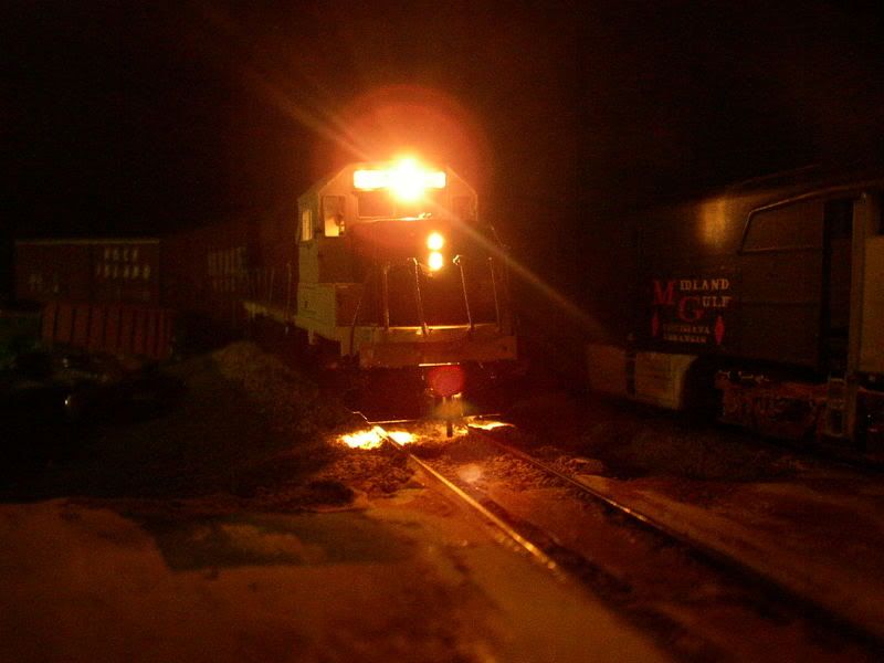

This is what I’ve been working on for the past week. I wanted headlights in the nose AND the top of the cab, just because I wanted them.
The bulbs are Radio Shack 12v 60mA terminal base types. They’re connected so that they get their power directly from the wheel pickups (you guessed it, they don’t dim and can’t be controlled from the throttle) and have a brightness that commands instant respect. To deal with the heat issues of the cab light, I wrapped the bulb in aluminum foil that extends one inch back over the wires, acting as a heat sink. This dissapates the heat without harming the plastic shell. It also directs the majority of the light forward.
This is how it looks in the dark.
I have since blocked off the light shining down onto the track.
Nice work, Jeffrey. I like the effect, and would like to see another image with the drop-down light blocked.

Love the lights jeffrey. Are you using the bachman decoder or is it already hard wired into the system. Just curious because I just ran similar lights in my gp-19 and Hooked them into the bachman decoder blue and white leads. Now I can turn them off or on or dim them to a lower effect. The only thing I haven’t figured out is how to wire them seperately so that I can have forward and reverse light seperately. How much were those bulbs at radio shack and did you have to use a resistor?
rs2mike
The lights aren’t connected to the decoder at all. At 12v, 60mA each they pull to much for the cheap Lenz decoder to handle. That would be 120mA for the bulbs alone and the decoder function output is 50mA. They get their power directly from the trucks. I don’t remember right off how much the bulbs cost. Less than three dollars for two, I know. As for resistors, I would only use them if I wanted to connect the lights to the decoder, which I don’t. That would cut their brightness way down.
