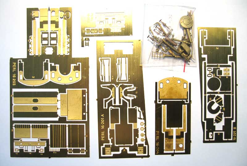

They are all kits, for the steam locomotive I used a chassie that I modified.

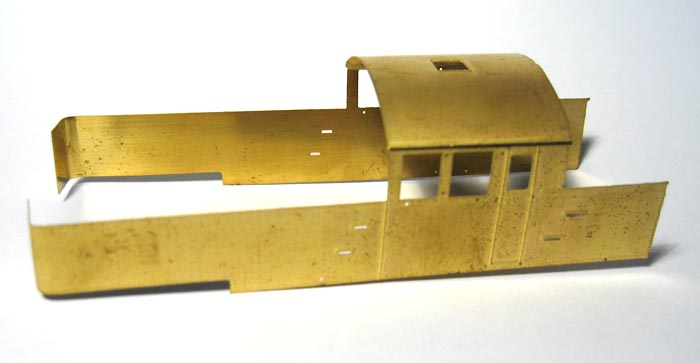

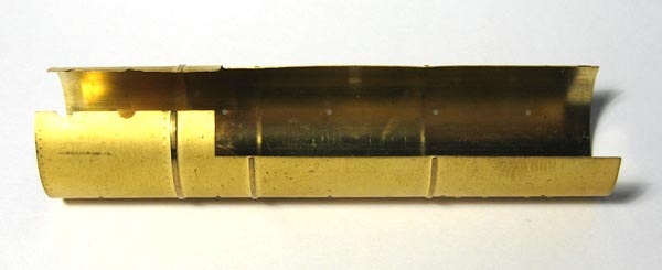

Here is som pix during the bulding.
The boiler.

For the steam locomotive I used a Trix, German BR73, chassie that I altered heavely.
All the models are made from etched sheets, see pix.
