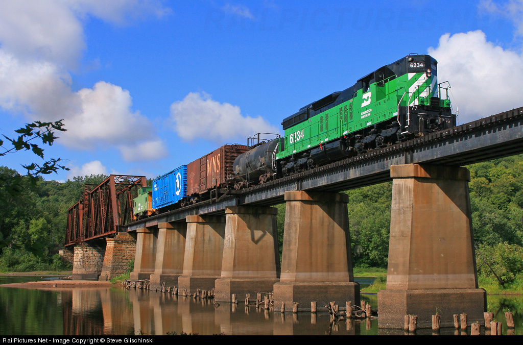

The bridge on the CN Dresser Subdivision from Wisconsin to Minnesota across the St. Croix River was an armstrong. Steam boats passed north of the bridge when it was built in 1882 but I doubt that lasted long. Steam boats were built in Osceola, WI and before the railroad provided transportation up and down the river. Once the railroad was in, I suspect the steamboats faded.
Word is that the bridge was high enough that it didn’t need to open for the steamboats but law required that all bridges below a certain height be swing or lift to clear river traffic. The bridge rotates on a center pivot with a gearing system run on a vertical shaft in the middle of the bridge. The section crew rotated the bridge every month to insure it was in working order. The bridge no longer rotates as the rail was replaced across the bridge gap and the rotating mechanism removed. The telltails to warn the brakemen still hang over the track (a testimony to the rugged construction of that era) and the bridge is rusty but still looks good. The most interesting part is that an Osprey makes her nest on the east end of the bridge every year and squawks at us for the first few weeks of the season until she gets used to the train passing by.
http://www.railpictures.net/images/d1/6/0/9/3609.1221015514.jpg
For petitnj:
Copied to activate link in Thread! [:-^]
