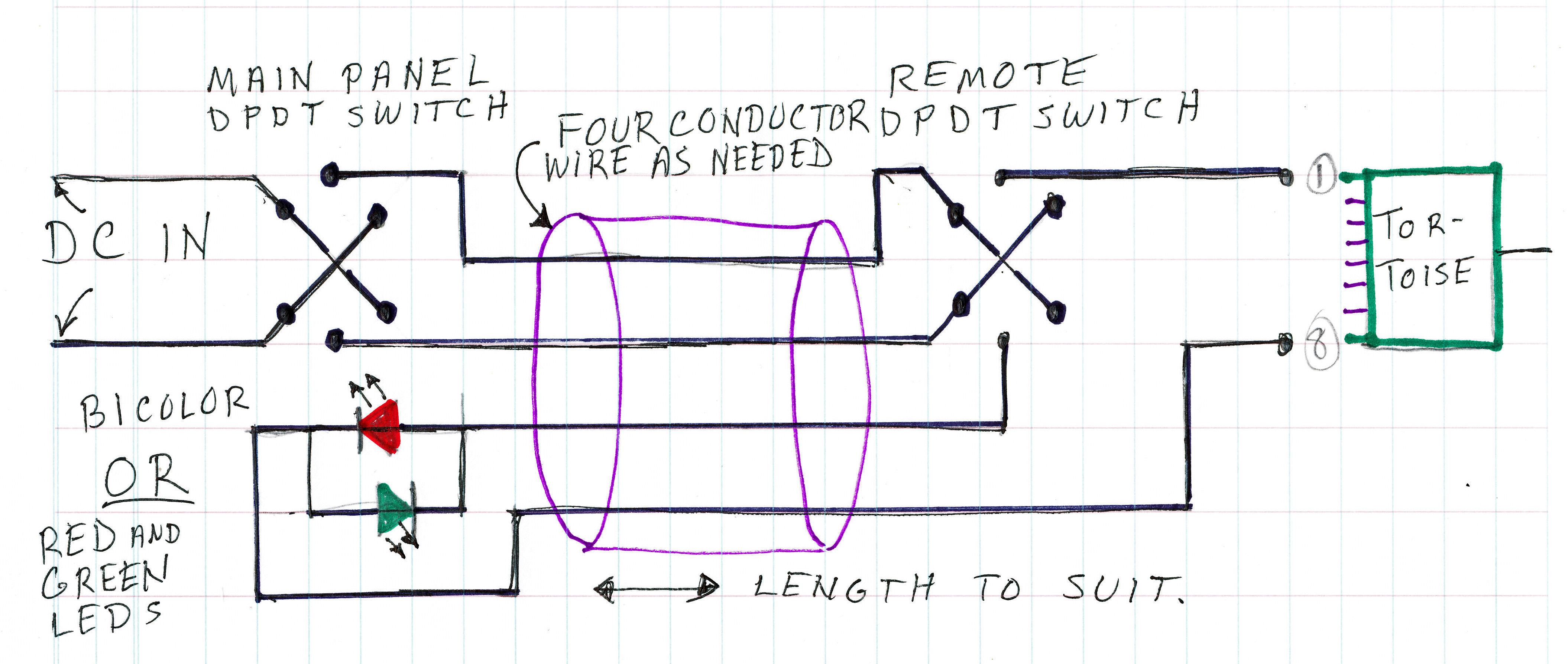

Hope I can explain this clearly. I have a turnout that needs to be able to operate from two locations. Installing the two toggles is easy enough and that works fine. Here is the issue: One of the toggles is out of sight of the turnout (across the layout) so I have tried to make a panel with leds on the remote side. When the turnout is set for “mainline use” the proper led lights up and only that led is lit. When I throw the turnout for the diverging route both leds light up. Can someone assist me here? Thank you

A lot depends on what type of switch machine it is.
I use Tortoises and they are pretty simple to set up for ‘remote’ locations. Especially since the LEDs can be in series with the operating circuit and bicolor LEDs will show the proper point orientation. I use this arrangement:
Tortoise-again by Edmund, on Flickr
Note, if you want indicator LEDs at the ‘remote’ location simply duplicate the arrangement on the left (main) panel.
If you use twin coil machines you’ll have to wire the LEDs with resistors and use something like an Atlas ‘Snap’ relay to provide the outputs to illuminate the correct LED.
Regards, Ed

Thank you. I am using a tortoise machine. I had the two toggles/leds connected by three wires.
Well, the DC input is only two wires and the Tortoise is only two wires (pins 1 and 8).
So all you’re doing is reversing plus or minus each time you want to ‘throw’ the points. You can have ANY number of ‘cross-wired’ DPDT reversing switches between the source and the Tortoise for ‘remote’ locations.
I have a few that require up to four LEDs in series with the power lead. Each LED reduces the available current to the Tortoise so if you have more than a few you might have to bump up your supply voltage to overcome the drop, or live with a very slow Tortoise.
Some two-wire LEDs can simply be placed in series on One Side of the circuit. A bi-color LED simply has two ‘back-to-back’ LEDs inside the capsule. Of course you can use single LEDs wired cathode to anode as the Tortoise wiring diagram shows.
Regards, Ed

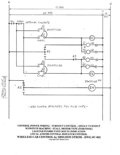

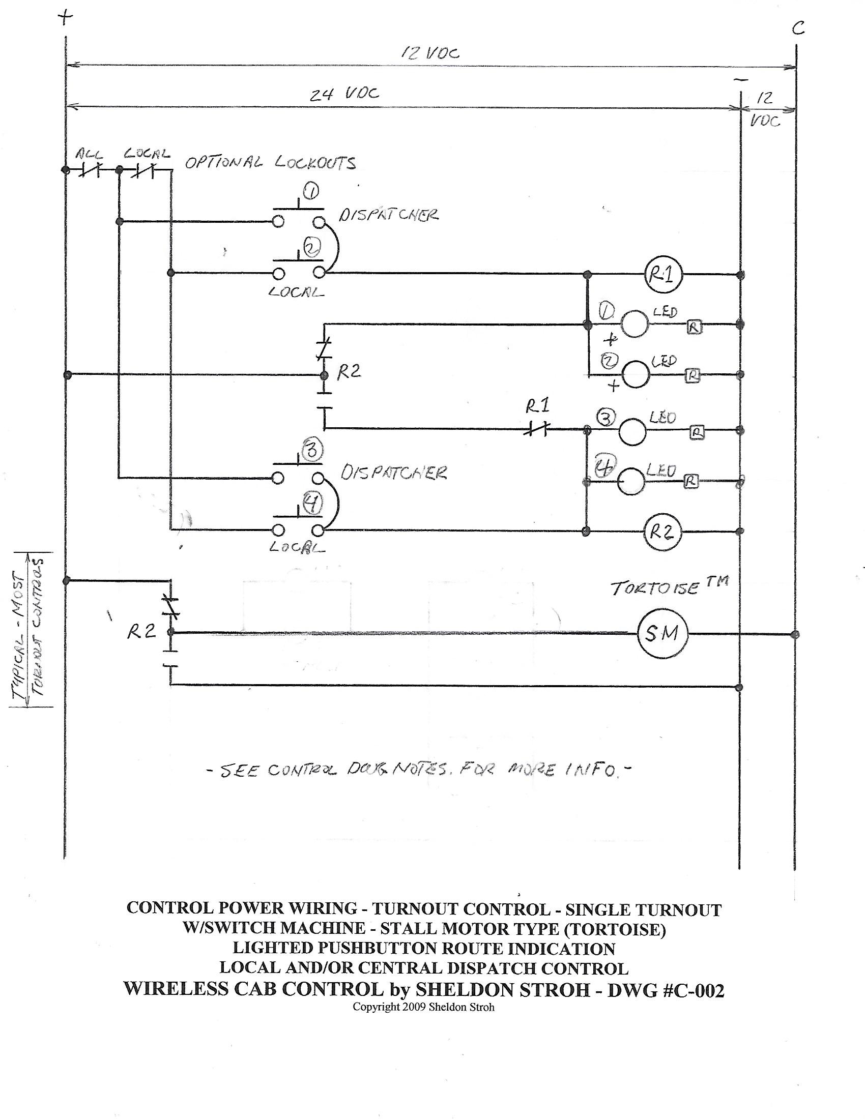

Or, you can do it like this with push buttons and two relays. I use lighted push push buttons mounted in the track diagram.
You push the button for the desired route, the turnout changes and the buttons light up at both locations.
Sheldon

Just want to take a moment to thank Ed for his help in solving my problem. I made a mockup arrangement using Ed’s schematic and it worked perfectly. Thanks again.
