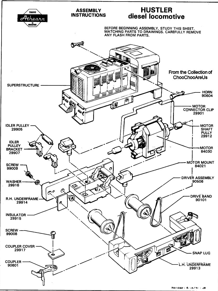

For Christmas, I asked my parents for the remains of my childhood train set. It’s been poorly stored (mostly my fault for where I put it way-back-when) in a damp and unheated area. I was able to get all but two of my engines turning last night (way exciting). Anyway, I have this switcher and was wondering if any one of you could help me out. When I opened it up, I noticed each axle was belt driven. The “belts” had since solidified and when I touched the first one, it crumbled. The second one did the same. I would like to replace them and was wondering if you had some ideas of what I could do. I also wanted to see if any of you know what brand this might be since there is no branding ID on it that I can find, and also, if this actually models a real switcher, what type of switcher is it?

It is made by Athearn, called the “Hustler”. As for the drive belts you can go to their website and order more belts, which are basically rubber bands, or just try to find some smaller rubber bands that will fit, nothing “exact” here, just make certain that they aren’t too tight or stiff.

From the motor and power pickup, it’s not an original 50s/60s Hustler. They had an open frame motor and a wire held with a screw from one sideframe to the motor. This one is probably late 70s or 80s production, maybe later
The “gold” casing on the motor puts it more towards the 1970’s-1980’s. In the 1960’s-1970’s the motor has a “silver” casing.
Might be this one: http://hoseeker.org/assemblyexplosionAthearn/athearnhustlerdiagram1991.jpg

Wow, thanks for all the helpful information. Since my first post I went down to the local Ace and picked up some O-rings. 5/8" ID worked okay, but the ring itself was a little thick and was binding slightly between the ‘idler pulley’ and the drive axles. They didn’t turn very well over the motor shaft pulley causing the engine to make more revs than it transferred to the the drive belts. Needless to say they didn’t work.
Today I went to Tacoma Trains and looked around. Holy cow, I felt like I was ten again. However, I picked up some Labelle 108. I came home and lubed up any rotating pieces. I also decided that I’d try a couple of my daughter’s hair rubber bands as drive belts. They worked great. Now I just need some couplers and I can pull some cars with it.
