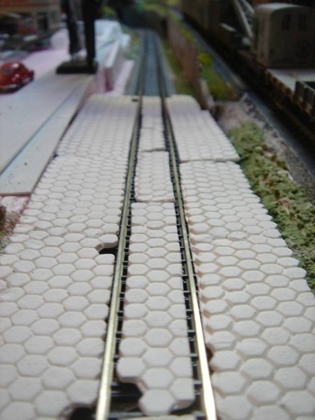

I thought of doing a street in these cobbles:
After doing this short stretch, I was glad I didn’t do any more. The cobbles are a Hydrocal casting from a mold I made using a piece of artificial honeycomb. It’s not too bad making a slab, but when it has to go up to the tracks, the casting is way too thick so I had to Dremel off the back until the whole thing was wafer thin. That’s why there are “missing” cobbles.
