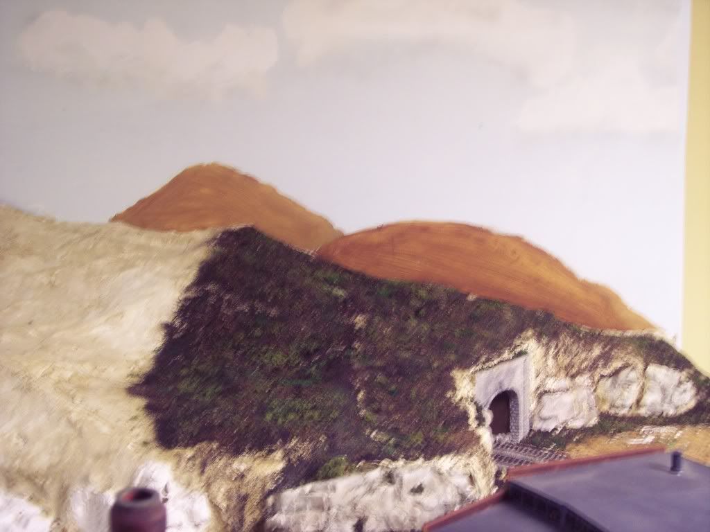

Hi all! Just thought I would take a moment to show my first attempts at backdrop detailing. And when I say detailing I don’t mean “detailed” like a photograph! As many of you know, my layout is set in New England in the fall. Previous layouts I have built have all had backdrops but nothing more than sky and clouds. I wanted more. To extend the scene so to speak. I’ve read about every imaginable article on backdrop painting and watched different videos and believed I had learned enough for the time being. So this morning I decided to just jump in and get on with it. I first penciled in my hills and mountains and ridge lines. Using tan acrylic paint I colored in the land furthest away and then using darker brown acrylic paint I colored in the land closest to the 3-d scenery. Like so…sorry for the blur.

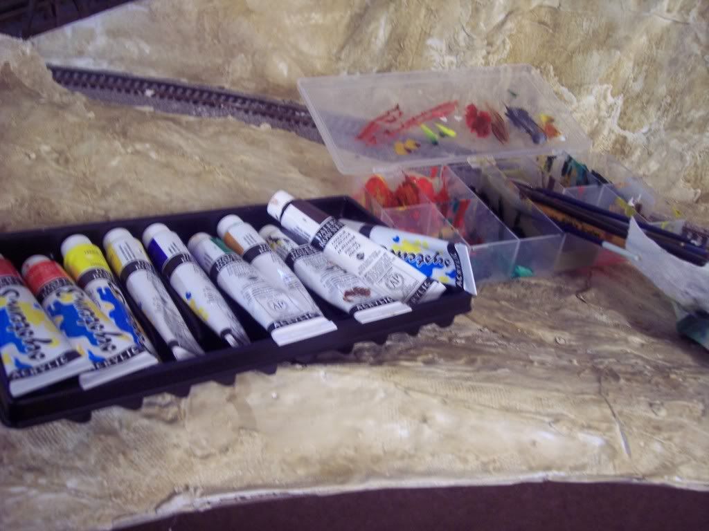

Then I grabbed an assortment of different brushes, a cheapo set of artists acrylics and a small plastic organizer box I used for water and the compartments for blending colors. Kind of like a poor man’s palette.

One thing I might suggest is that instead of using one of your divided parts boxes, get a dozen eggs in one of those new see through cartons. They have 24 compartments and a large flat area also. I have several of them waiting in the wings for when I get the paints out.
