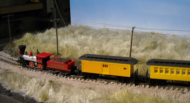

Here are two examples of Silflor 6.5 mm static grass appliied with static grass gun.
Guy
Guy. great looking grass!! Looks like I’ll have to invest in a static gun.

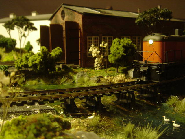

I use WS field grass:
I haven’t done vast fields off tall grass, though. Field grass as packaged is a tad tedious for large areas.
I have also used balls of poly fiber and ground foam to simulate underbrush:
As well as WS Foliage:
