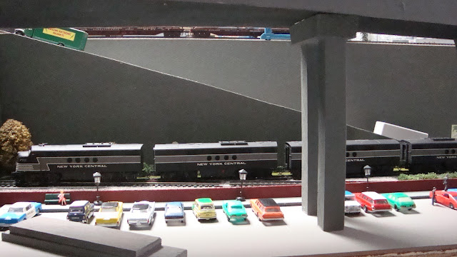

A DC Bachmann FT A-B-B-A lash up.
A Walther’s FA FB FA lash up
Athearn BB PA-PB-PA
