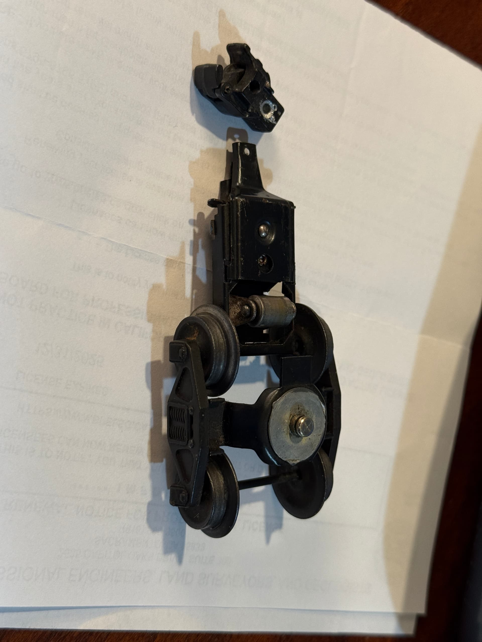

But more to the point I have a broken truck. I need a part number so I can order the correct part. It is the coupler in particular that is broken. The attaching fastener (I assume a rivet) failed and the pin that locks the coupler is gone.

It appears to me that your coupler has been ‘butchered’ by someone crudely drilling out the rivet.

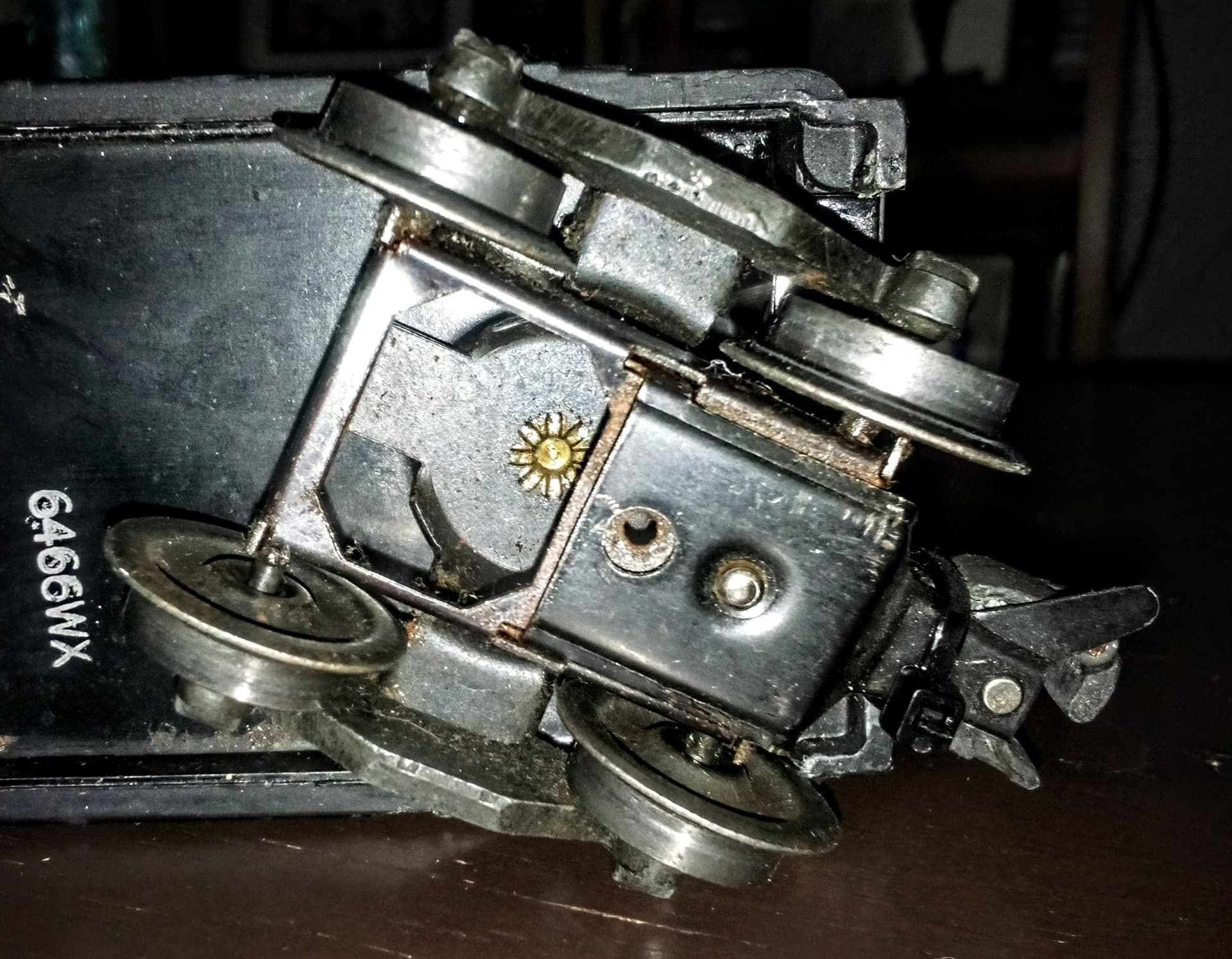

This is a 6466WX tender, the whistle mechanism and the roller need repair so that’s why you don’t see them. But you can see the rivet for the coupler release lever. This one is really loose because the coupler itself is pressure fitted to the plate and after 75 years it needs a little help. A black zip tie works well.
