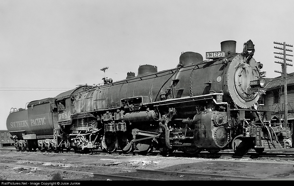

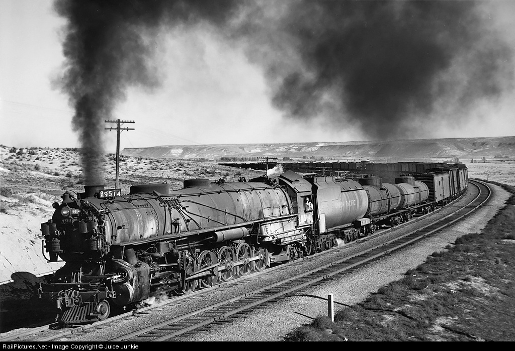

Did UP or SP use vanderbuilt tenders?
Yes:
I would be tempted to bet real money that neither Santa Fe nor Northern Pacific had any.
And, before you ask, SP&S had 4.
