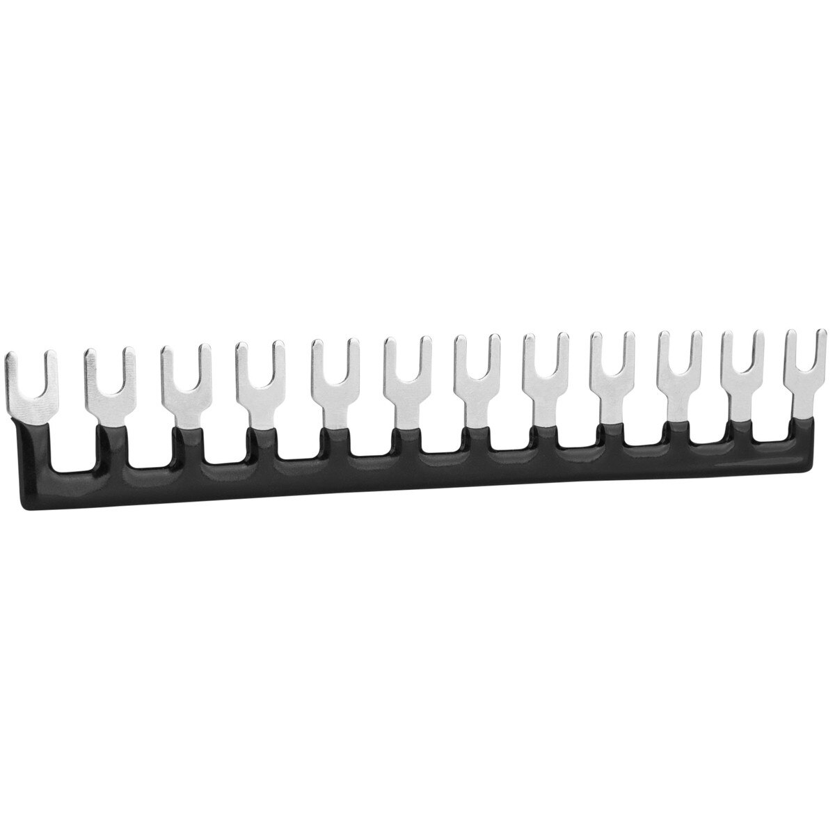

Are there any terminal strips that will connect one input wire to multiple output wires without having to gang a bunch of terminals together as on a barrier strip?
Mark
See gmpullman’s last post…
— even more choices:
https://www.ebay.com/sch/i.html?_from=R40&_trksid=p2047675.m570.l1313&_nkw=power+distribution+board&_sacat=0
Maybe the link in my previous reply doesn’t work for some browsers.
Good Luck, Ed
jumpers ?
