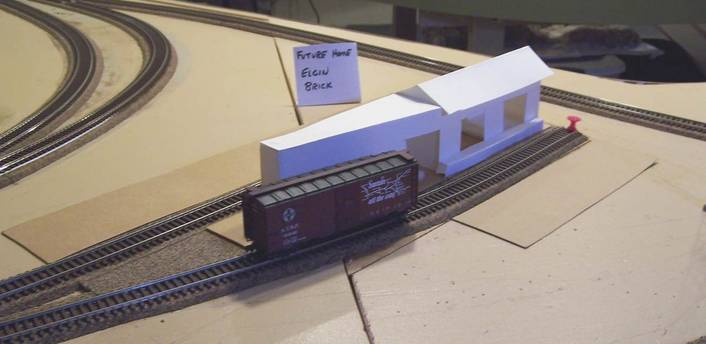

Agree. I’m only just starting. When I found this actual model in the Elgin depot I made a spot for it on my layout. I could wait until the cows come home and Walther’s or someone provides a kit … and charges phenomenal prices, or, this is the opportunity to start a scratch build project.
I had some card stock and decided to rough out how this might look. As woodlandtoots wrote, practice, practice and more practice. It’s a start. I saw in Walther’s catalogue a picture of a building using the modular pieces that might start to approximate this. I’m going to try that first. It will be fun. I stongly suspect though that after that experience with one building, I will probably just go and get the raw materials.
Regards,
You can do it that way, but three are easier ways. If I wanted that look, I’d use styrene for the walls and Campbell’s roll shingles over them. Then stain (I’d paint them using artists acrylics) the shingles to match.
I’d use Harold’s way only as a last resort. To me, that method seemed like a lot of work.
