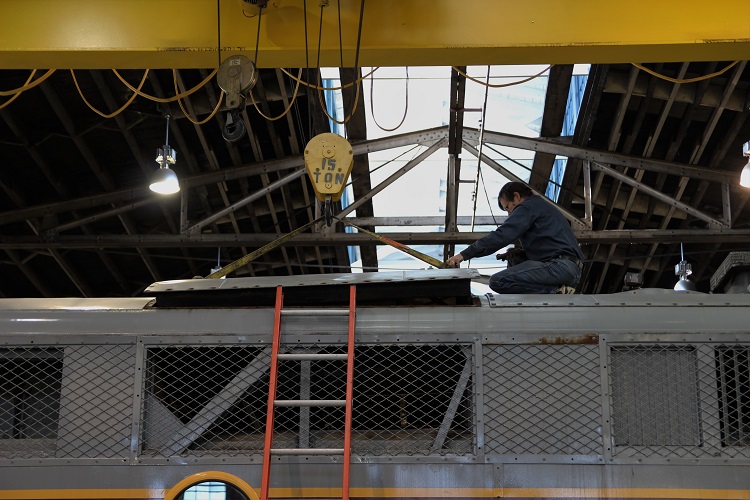

The 4440 also has exhaust stacks identical to those on the 1907, and the little tiny thinga-ma-jigs sticking up are lift rings - used in the shop or roundhouse when internal equipment needs to be removed from the locomotive for servicing - an overhead crane, with hook-equipped chains or cables uses them to remove the roof panel, and there will also be suitable attachment points, for the hooks, on the equipment that’s being removed.

Edit: Here’s a LINK to some lift rings, and the removal of a roof hatch can be seen HERE
