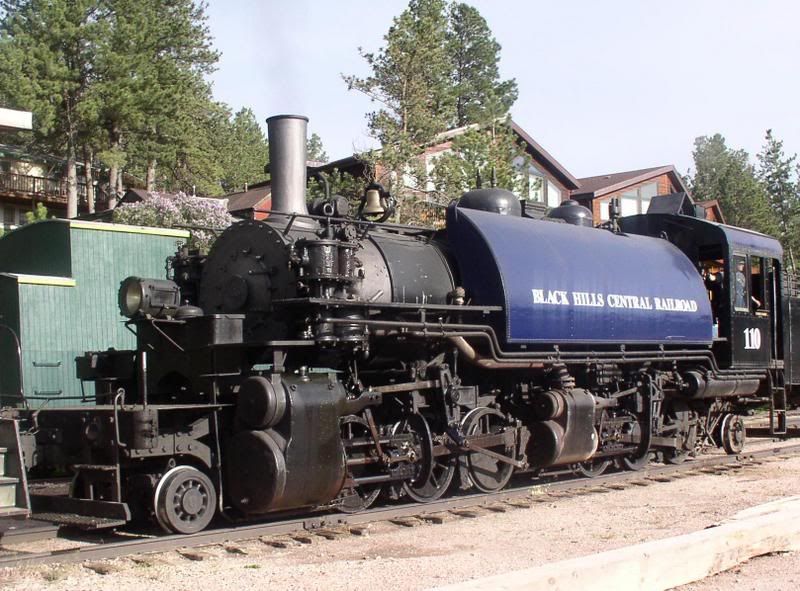

The 110 has the low pressure cylinders on the front which are larger. It sounds great while going up the grade. On one occasion we had to stop between grades to build up more steam. I believe we had a longer train than most days.
Yep, that’s usually where you find them - the high pressure cylinders exhaust into the low pressure cylinders, which exhaust into the smokebox. The Canadian Pacific built a class of 0-6-6-0s with the leading cylinders at the back of the leading engine, presumably to keep the connection between the two sets of cylinders as short as possible, but that was unique (at least on this continent).

It’s the opposite: the low-pressure cylinders (generally in the front) are larger than the high-pressure cylinders in the rear. To get the same force with lower-pressure steam pushing the piston, you need a larger-diameter surface for the steam to act on.

In the late 1970s, I spent quite a bit of time around then-operating California Western Railroad 2-6-6-2 Mallet No.46 (ex-Rayonier Corp. No.111, sister to the No.110 now in use on the Black Hills tourist operation). The CWR rebuilt the 2-6-6-2 without the split saddle tanks, which compromised her balance, riding quality and to a greater extent, her tractive effort.
Yes, the exhaust sound of a true Mallet under load is mushy compared to that of a simple locomotive. But when CWR 46 attacked the stiff 2.75% ascending grade over the 8-mile stretch from Shake City to Summit with five fully loaded steel passenger coaches behind, she still talked loud. On one occasion I’d arranged with the CWR Roadmaster to ride in his Chevy Hi-Railer ahead of the steam train to a point called “Rock Wall” about 1.5 miles west of the Summit. My buddy Walt and I awaited the train there, and could hear the locomotive laboring up the forested grade and through the torturous reverse curves for the best part of
