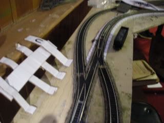

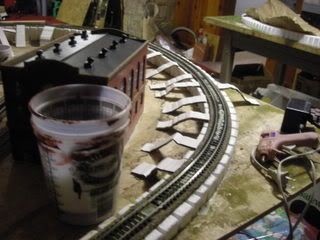

Rough Scenery

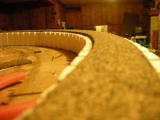

laying cork for the main line…

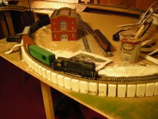

GP-38 attacking the 2 percent grade
Topping the grade

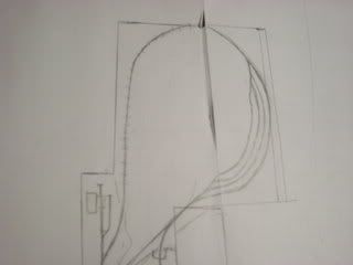

Nice! Can you post a track plan? It looks like a fairly big layout.
OK, this bit of information is from my own experience.
Your cardboard strips should be glued to the sides of the WS foam grade forms, and not the top as you show. The reason is that once you lay the plaster cloth or plaster soaked paper towels on it as you have them, it tends to bring the “ground” scenery up to the level of the track, almost hiding the cork roadbed. The better solution is to glue them to the sides with the tabs or ends pointing down, then bend the strips horizontal right at the top of the grade foam or a little below it. I think that you will find that will look better once the plaster cloth is applied.

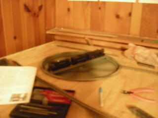

Well, i know its a little late but a few weeks ago the a 130 foot turntable was installed on the Ralston Midland.
And since someone asked for a track plan, here it is. Didn’t use a special program, rulers, or anything but paper and pencil, so as you imagine we had to changed a number of things along the way, but its all good…
