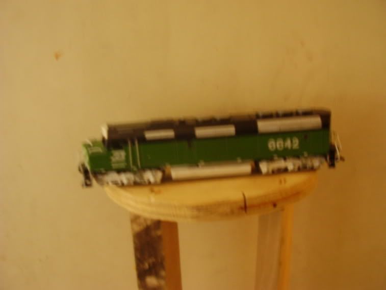

The photo isn’t as good as I hoped. This is my first attempt. I’ll get better. hope it works.
Hey guys, how is every one? I have good news, I just saved a bunch of money on my F45 by switching the motor. -lol. Some may remember my post last month or in Dec. 2005. Can’t remember. Any way, my post was asking for a better chasis drive for a Athearn F45. I even asked for Antoinio FP45 advice. Everbody who responded gave good useable advice.
My thoughts was maybe a SD45 was the answer. Some said to repower it with PPW motor and chassis. I did no of thoes. It just so happen, I had 2 P2K FB2 (POWERED) laying around. It was being used, but I said to myself, I don’t need 2 Powered B units. So I took the motor out of one of them. Remember, in the P2K FA/FB. they have the same 4 hole in the midle of the chassis like Athearn BB. But the motor is much better. Fit like a glove. Way smooth and I must be deaf because I can’t hear a thing. Also, I didn’t have to buy Nickle plated wheel to replace the Athearn wheels. I also took the wheels of the FB2 and replaced the FB2 wheels with Athearn dummy wheels. Now everybody (my locos) are happy agin.
Now, time for details on the F45. I painted the fule tank and the trucks (platnium) to my standard’s along with the side grills and fan vents on the roof(same color). Just to let you know the road name of this loco, it’s THE BIG BN #6642. I added the number board #'s too and made the cover to the lens white.
I even took it a little further and made the number board light up. How? I drilled 2 holes behind where the number board pops out from. Looks great. I also added grab iron to the front of the hood where Athearns had just the immitation lines. 1 more thing, I also painted the front and back step grill’s. I added at least $40 -50 more detail to this engine and now it’s my favorite again. I wish I could post pi

I LIKE THAT PHOTO! Very cool version that could have been. If you can, please take closer shots of the side, front and rear and post them.
Your shot is slightly blurry. You may need a bit more lighting.
In any case…Super Cool![:D]
Thanks Antonio FP45. I know this is your kind of loco. This is totally freelanced. I wanted a new look . Something to make you stop and say whoa. You mentioned that you bumped up the photo! Menaing what? Did you make more clear? Where is it? I would like to see it, but now that I know how to do it. Expect more BN photo’s for sure.
