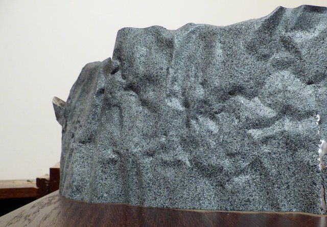

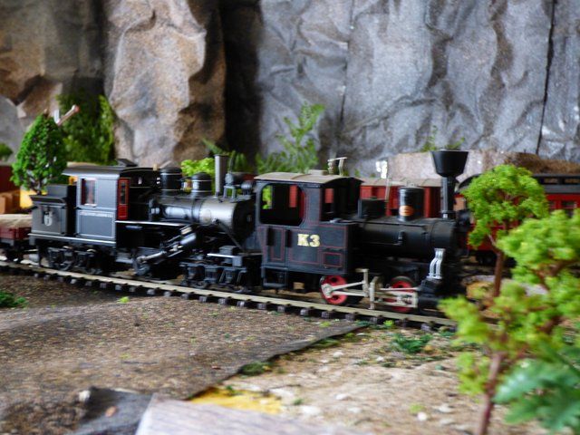

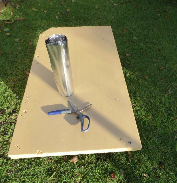

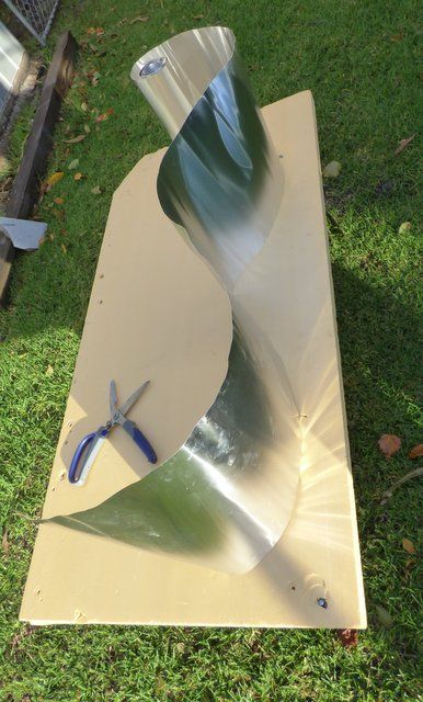

Here is what I am developing. The use of aluminium as scenery. I buy aluminium flashing which comes in 10 metre rolls x 30cm (or 15cm) wide x 0.03. This I cut to size and then I shape it to create rock. Typically a length would be a 1 or 2 metres long. The method of shaping was originally to place it up against a rough textured tree or a large rock and bash away at it with a hammer or a hand held rock but now I simply place it on the lawn and crush it with my feet as well as hitting it with rocks and crumpling it with my hands. It will not split ot tear.

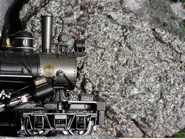

Then I paint it with matt black and then it is finally sprayed or brushed with a texture paint. My favorite for mountains is a darkish granite and for horizontal surfaces any number of light stone applications. And that is it.

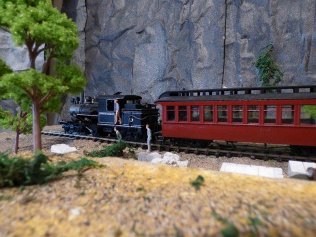

  • Realistic: A granite cliff face for example is as close to the real thing as could be imagined.

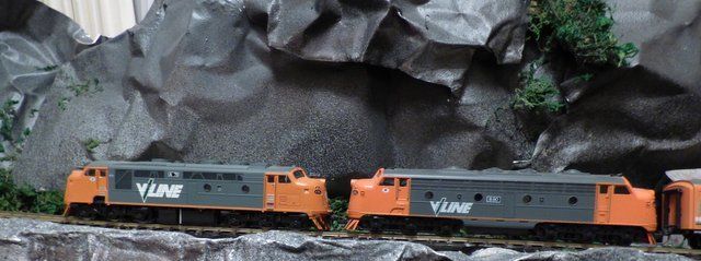

Here are some photos of aluminium scenery. Several more to come,/

Beautiful work there, Sandy.[tup] Please show us more. That’s a far classier mountain than my snip-and-bend, 2-minute wonder. I’ve still got lots of flashing left to experiment with.[8D]

Very complimentary, Steve, but I am not a particularly skilled model maker and I am sure that once those people who really know what they are doing, get going with this material then we will really see something. I really only got going with all of this a couple of weeks ago when I started to make my third model railway. The first was around 1956, the next was my garden railway in 1999 and now this one in ON30 plus the European Oe scale which is 1:50 cf On30 of 1:48. The Euerica ro stock is all Fleischmann Magic Train, now no longer made but there is plenty available on ebay. This suits because I have Parkinsons which means that I drop things and the Magic Train is very robust and does not break easily. Also the stock is all 4 wheels so it is also easy to rerail. Additionally we (my youngest son and I) also have Bachmann locos such as the CLIMAX, Shay, 4-4-0 and others. as well as the Australian Coffee Pots(both versions) and the Baldwin 2-6-2T by Haskel
The plan was to make an island railway set somewhere in the Pacific, close–ish to Australia (although sometimes it drifts over to South America – hence the Inca / Aztec ruined jungle idol tourist branch line).
However I quickly got bogged down by the whole plaster of Paris business. After a few hours of this I gave up rather like those model ship makers who get no further than a couple of hours into the rigging and call it quits – there must be thousands of semi – derelict model ships in cupboards throughout the world – and model railroads too.
Then I stumbled over 0.03 aluminium and away went again. There is a plenty of scope for improvement – make it seamless for a start and the textured spray paint is often only for interior use only. The three key

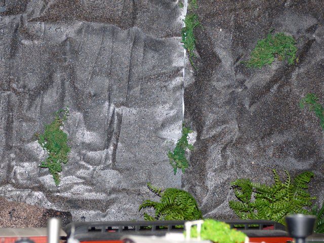

I made up a yard long length of scenery today and learnt a lesson. It is not that hard to underestimate the appearance of real rock and end up with what just looks like a pile of twisted metal.
It needs care in ensuring that the folds, dips, outcrops and so on to look real. I attach a couple of photos to show what I mean plus a couple of others to show the process overall.
The 0.05 sheet is too hard to be kneaded or used as interior scenery. The thought did occur that if you wanted to make a narrow gauge layout that was really different then how about a model of the construction of the Hoover Dam. 0.05 sheet would really suit in this case.
