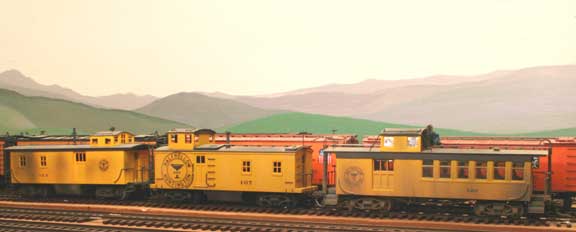

C’mon fellas, show me your hills and trees that you’ve painted on your backdrop. Maybe I can get a good idea or two, Lord knows I need it. I think maybe my problem is I tend to get to detailed. Can’t do that, I’ve got about 45 feet of backdrop to do, and I ain’t that Italian feller that painted the ceiling on that Church! I’d like to one day get back to running trains again!
Photos below show what I’ve done so far and it’s not much.
My practice board
Jarrell
Yeap! Them dar hills be alright!
As far as Im concerned you are the king of backdrops now.
I gotta break the habit of getting too detailed though. And I’ve gotta be consistent. Right now I’m not either one. I’d sure like to see others backdrops and maybe I’d see more about what I’m doing wrong.
Thanks for the kind words! :slight_smile:
Jarrell
Ok, The picture shows a gigantic white cloud behind your locomotive between the distance peaks and the ground level. Is it possible to lose one’s concentration while up in the clouds?
Hows that for a start?
