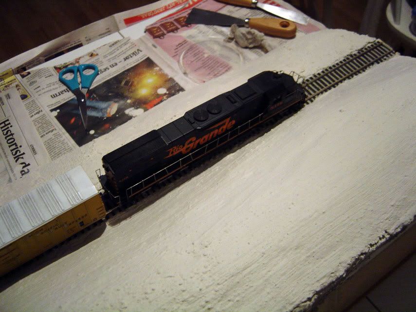

This is what I have done the latest week...
I decided to build a little diorama to try Joe Fugate’s methods. In this picture I have spline roadbed, I glued the track with gray latex caulk. I built the scenery with cardboard strips (hotglued) and 2 inch masking tape, and over that 2 layers with Joe’s vermiculite mix. I’m waiting for the vermiculite mix to dry at the moment. I think it will take a couple of days. After that I will paint it tan, weather the track and ballast it. Then it’s time to learn how to make trees and things like that. I will post another photo as soon it’s painted tan.

That texture looks really good. When I advised you in the past against vermiculite, I was thinking back to an old product I used that was called Moutains in Minutes which was vermiculite based. Horrible product. Joes mix looks good. I might have to try in myself.
What size verm did you use?
Thanks. I used 2 mm because I could not find any smaller vermiculite here in Sweden. Use smaller if you can find it. 3-4 parts of water works for me.

Here is the update. I’m very pleased with the tan color. But I don’t like the texture. I’m 100% sure it is my vermiculite that is too big. It’s 2 mm. I will use 1 mm or less in my next attempt like Joe Fugate suggested in his scenery clinic.
