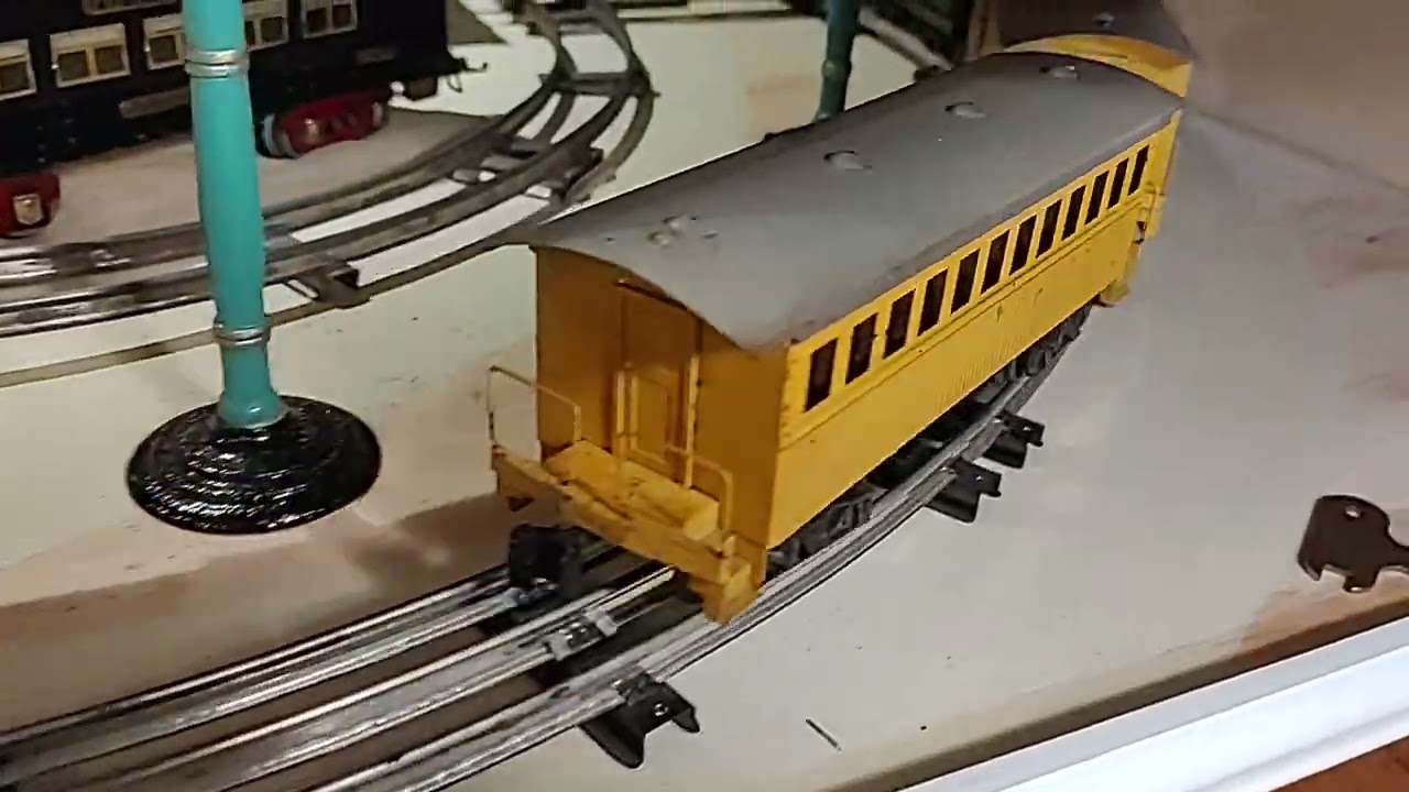

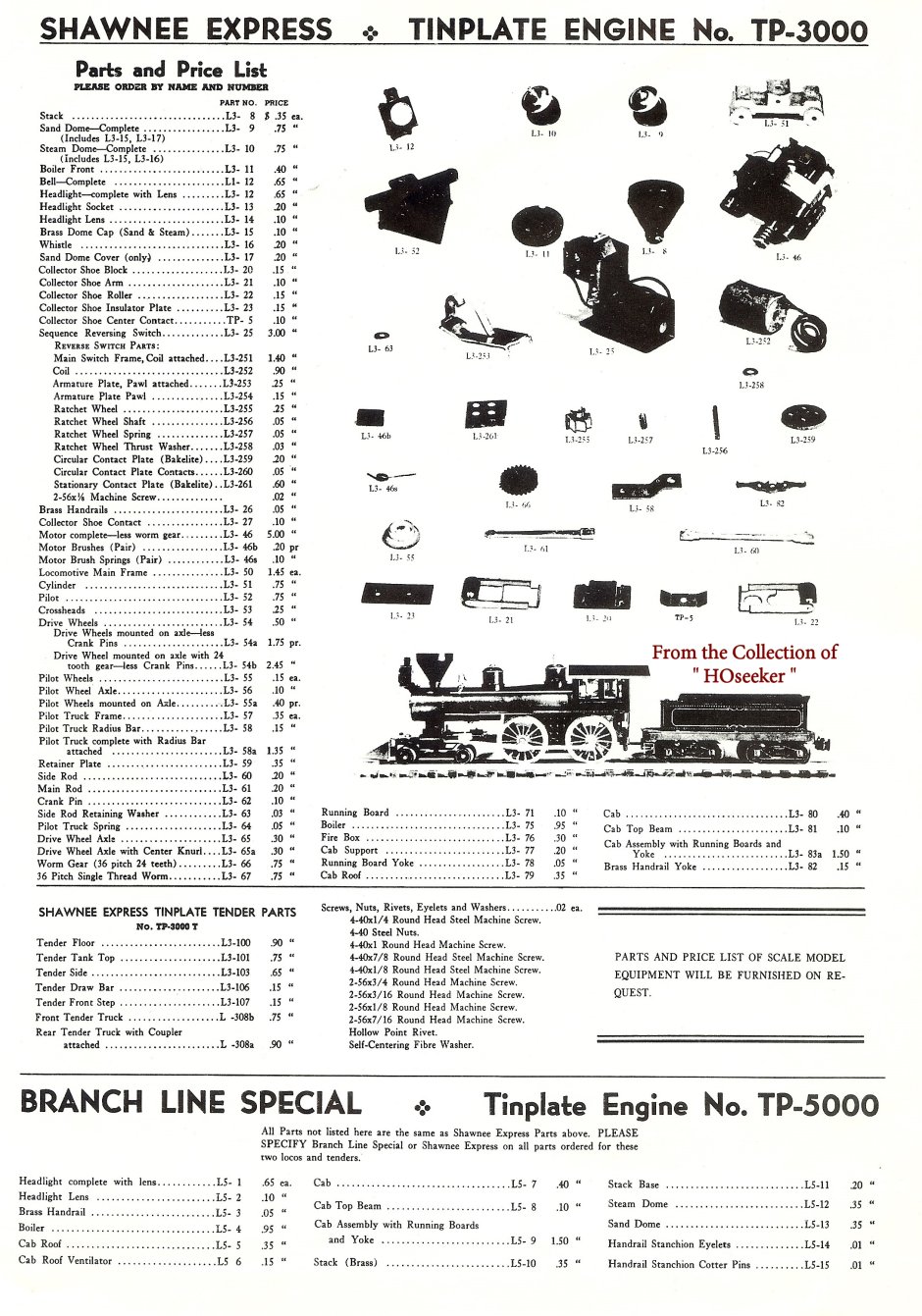

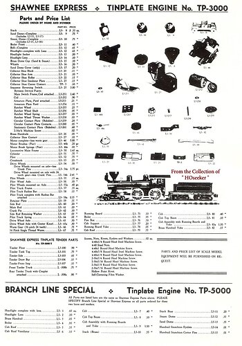

Does anyone out there have a Thomas Shawnee Express or Branch line special that they run? Do your e units stick?
Thomas Industries Trains’%20gauge%20rolling%20stock

Cute video but like all roundy rounds, kinda boring.

From the link you posted, “In 1951 Thomas acquired Scale-Craft and Company’s line of ‘O’ gauge cars and moved to a new facility in Shawnee, OK at 1125 E. Independence Street”
