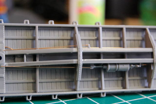

Tichy Boom Car project
I started this boom car about a month and a half ago, and had to stop because I didn’t have a pair of wirecutters I was willing to sacrifice to test on the PB wire… then I kinda forgot about it as summer began to get into full swing (even though I’ve had the wire cutters for about 3 weeks now, lol).
So anyway, here’s a few pics of my progress:
Heres a shot of the underside, complete with brake lines and everything:

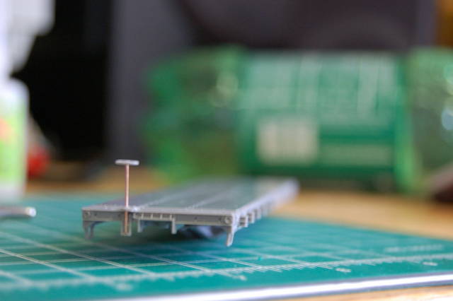

And this is a shot of the B-end & brake staff:
I took a few more, but the camera batt died as I was transferring them to the computer[#oops]. Maybe I’ll post those in this weeks WPF.

I used an Athearn 40’ flat as a boom tender for my Tichy crane. I lowered the flat, then replaced the deck with individual boards. The removeable toolboxes and the equipment shed are scratchbuilt from styrene. I decided to forego brake detail (with the fishbelly sidesills, it’s barely noticeable), opting instead for some extra weights. I added some details for fueling to the crane, along with sliding doors to offer a bit more protection from winter weather.
