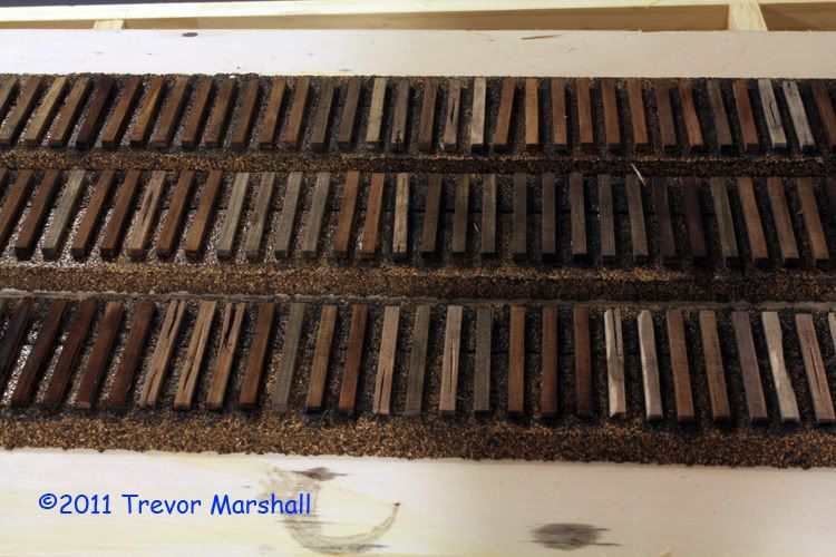

I’ve used oils to weather all the ties on my layout and I’ve written about this on my blog. Here’s the link to the “ties” category:
http://themodelrailwayshow.com/cn1950s/?cat=45
Not sure if it’ll answer your questions - but enjoy if you visit!
