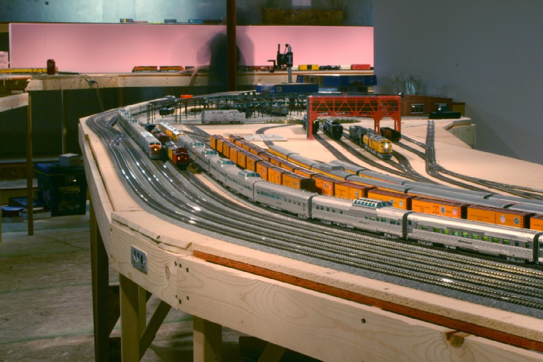

Here is a photo of two Zephyrs about to pass each other near the large roundhouse (under construction toward the top right hand side) and the reefer yard. I am taking the picture from the center of one of the curveback loops. This would just about fit in the space you indicated. Minimum radius on this layout (not mine) except the helix is 44".
image is acting strange so here is the url just in case
http://www.walkersquawker.net/images/zephyrs%20passing%20small.jpg
