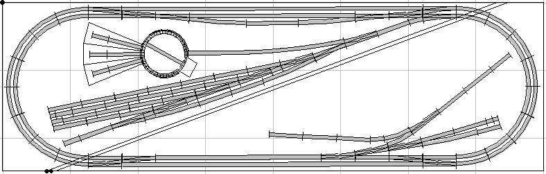

OK, In N scale that 5 x 9 HO layout would look something like this;
Click to enlarge
On this one the minimum curve radius is 12.5 with 13.75 easements on the main. All turnouts are #7’s. Should be able to handle the equipment you wanted with no problems.

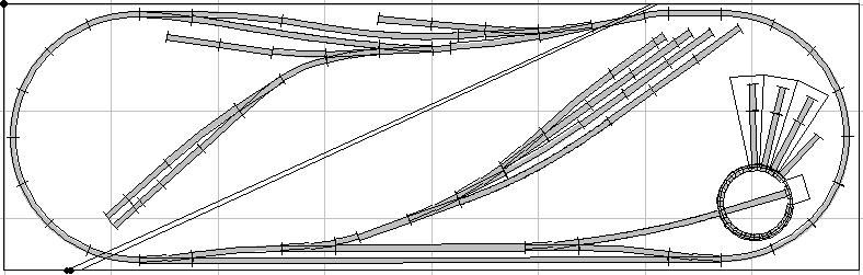

Here’s a slight variation of the above plan;
On this one the minimum curve radius is 13.75" with 15" easements on the main. All turnouts are #7’s.
Are either of these barking up the right tree? Or did you have something else in mind, and if so, what?
[^][:)][:D]Now that one is nice,Thanks
JIM[8D][^]
Hey, I was thinking about what you said about DCC, You know, with some careful loco selection you could do DCC pretty easily. For diesels most DCC conversions are pretty simple. You just unplug the DC light board and plug the DCC light board in and then snap the shell back on. Thats all there is to it.
As to the track plan, it has some limitations. It works better if you run it counter clockwise then if you run it clockwise. Since trains run both east and west this could be a bit of a challenge. Might make it fun though, huh? Also, there’s no real place for expantion for the future. I suppose the short spur on the top could be used for that, but other then that you’d have to cut in a turnout at your desired location. On the plus side, this one gives you three or four companies to switch, plus a small yard and a small engine facility. You could also add more tracks to the turntable and maybe even expand the engine house. There’s also room to cut in a RIP track if you want.
I made a couple of changes. Here’s a larger engine facility, a RIP track, and I think it works a bit better in this new arrangement as well. See what you think.
That’s a lot of enginehouse for such a modest yard, but we’re all a bit loco-heavy, aren’t we? I guess you could justify it by calling this a division point yard. Lots of trains pull in and change out the crew or loco, then head back out without breaking down the train.
Maybe Chip can suggest some improvements. He’s really good at that. He took my plan for my own RR and tweaked it in ways I’d never thought of.
BTW, if you have the Atlas RTS 7.0 track planning download I could Email you with the .ral file of any, or all, of these plans so you can manipulate them yourself if you want. Just click on my name on the top corner of any of my posts and use the Email link
