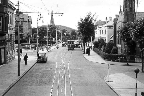

Yes, actually a gauntlet track is more like a crossing diamond, than a turnout. Nothing moves and a train can’t move from one track to the other. It may be spelled both ways, however, I have seen it gauntlet, more than gantlet.
Gantlet: Turnouts can be modified for each end of the gantlet section - Start by removing the points. The overlaping lines between could be made by adding two properly guaged rails to flex track, or even sectional track.

I heard that some places there were sort of gauntlet switches where the points were on one side of a road and the frog on the other, and the tracks in the middle ran parallel. This kept the parts that requires maintenance out of the roadway.
Here: this explains it much better and with pictures as well:
http://lios.apana.org/~craigd/ppt_faq/faq2.html
http://ransford.org/images/2003/gantlet.jpg
