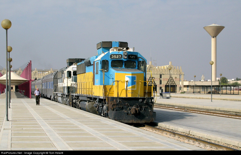

The following link is to a Railway Gazette photo of a Saudi Arabian Railways diesel; not the very large air filter on it. Photo linked @ http://www.railwaygazette.com/uploads/pics/tn_sa-northsouth-sd70acs-emd_06.jpg
A view of the other side of a similar sand filter installation for desert operaions @ http://www.arabianindustry.com/static/content/images/larger1/40074-377000.jpg
While similarly, an older ‘GP’ style Diesel fitted with oversized air filter for desert operations in a ‘Rail Pictures’ photo. Photo linked @ http://www.railpictures.net/images/d1/4/2/8/2428.1301970736.jpg
