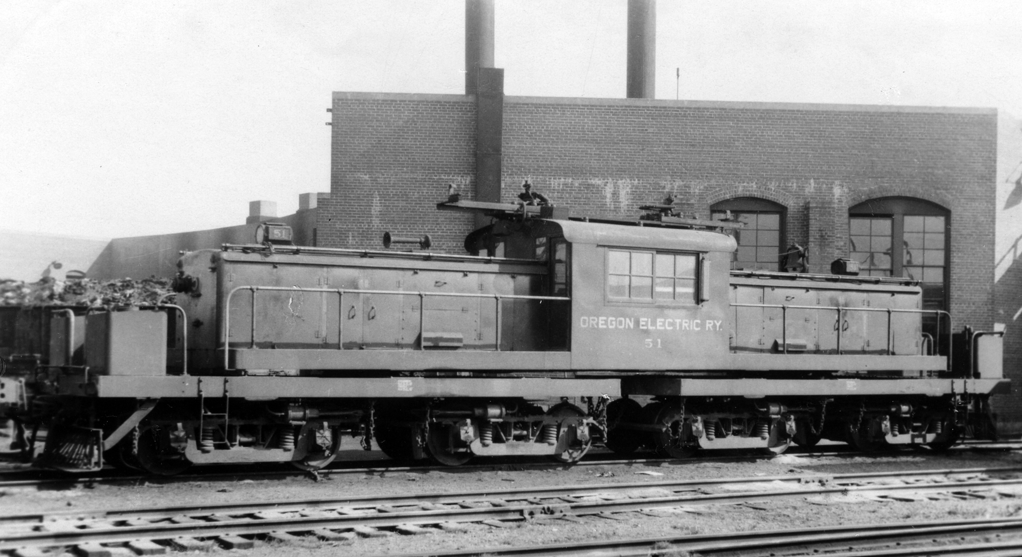

These cars ran on the Oregon Electric Railway. Which is a long way from Indiana. But there’s lots of information on the OE, including photos featuring the line poles. And their spacing.
Here, for example, is a photo that might help with pole spacing:
And, here’s something that might cause you to consider modeling the actual OE:
Ed
Prototype pole spacing won´t help you much, as you will have to consider the radius of your curves, which aren´t prototypical.
