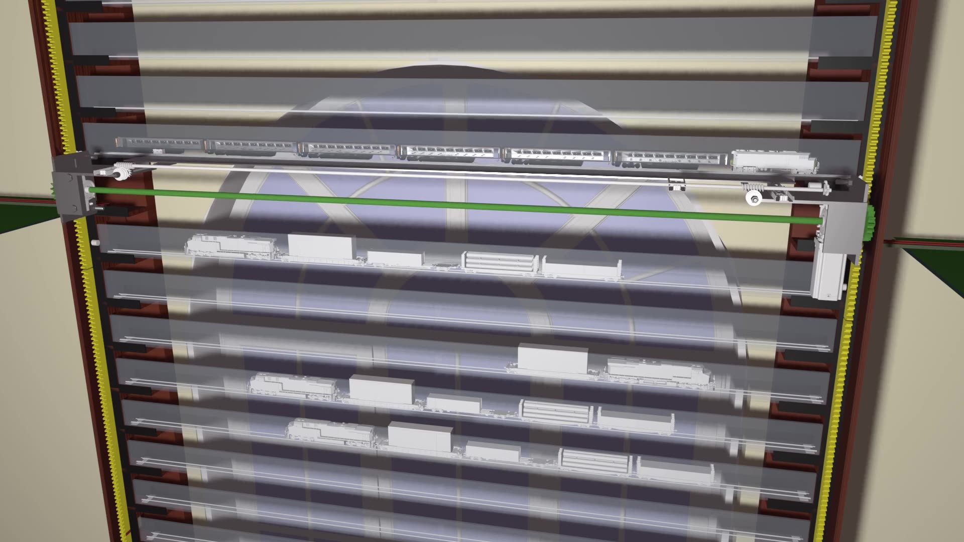

This design looks interesting. Not sure if it will actually work.
The systems I have seen use cables and pulleys, like the arrangement in a Mayline drafting straightedge. They could be counterweighted to help with safety. You’ll want some sort of positive alignment and locking at both ends; some of the approaches for hinged takeouts and duckunders might be adapted.
The modern idea of having individual drives at the ends, or drive wheels on tracks with shaft drive from the center underside, are possibilities.
the challenge is keeping both vertical and horizontal alignment
What about using worm gears and stepper motors, like in 3D printers?
