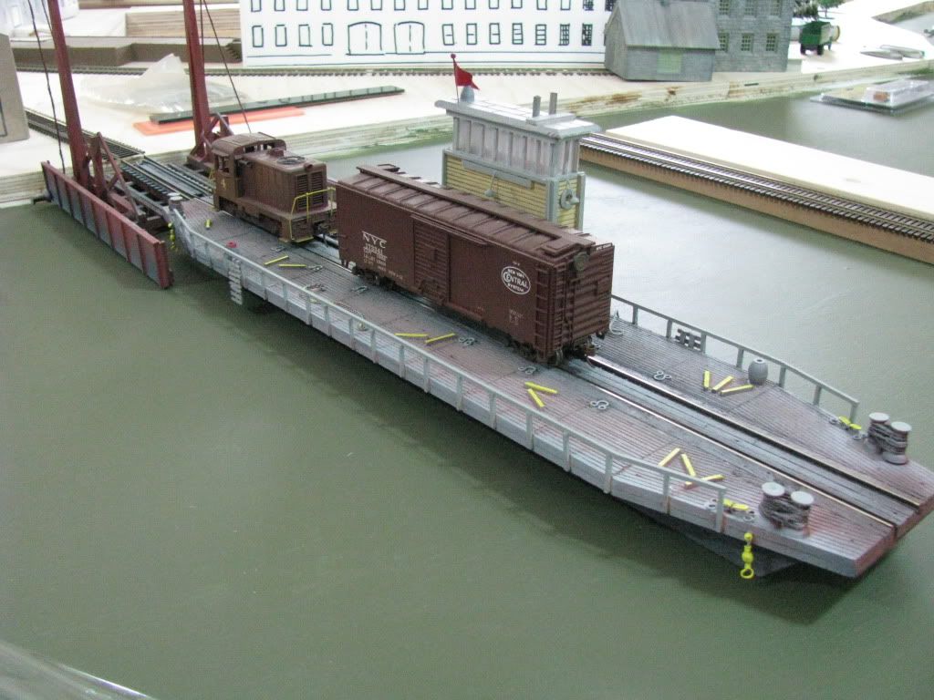

I have a model car float that I picked up on Ebay a couple of years ago and it is supposed to represent a self powered one. I haven’t found any prototype info on it but I still plan to use it on my layout. I also have a Walthers Tug model (yet to be built) that will be in the harbor as well. The car float was built by a modeler in Canada and does have a nice Charma to it but the details and workmanship could use some help. I will rework it when I get time for details; too much to do with basic layout construction now. I also have the docking pier he built which is in the photo as well.
bob
